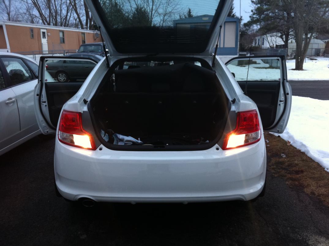

Cool Finally got around to it.
Sorry, I said a while ago I was going to work on it but finally got around to it. Tapped another 7440 socket from the driver side to passenger, drilled a hole with the notches out for the locking of the socket and now I have a second reverse light. YAY! lol It wasn't too hard, but if anyone else is going to try it, I definitely recommend trying to drill upside down. All the little dust and shavings are a pain in the ___ to get out of all the tiny little corners.
Here's a pic of the reverse lights on.

Good job! Now that looks much better! Normal too!

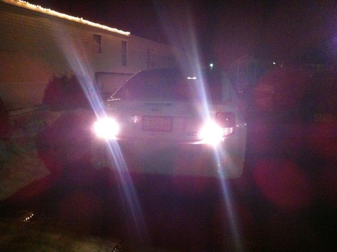

Here a pic of it now at night, nice and bright!

Looks great! And I hear ya on getting the dust out of the housing.
Cuz I'm curious, what did you use to cut out the notches?

I used a hacksaw blade by itself (no handle) to make the initial cuts. I cut until I got a couple centimeters from the line I drew. Then I took a small razor blade to get a little closer and finally a set of small files to shave down the corners to make it square, rectangle, whatever shape I needed.
