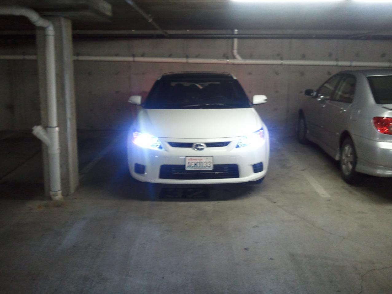

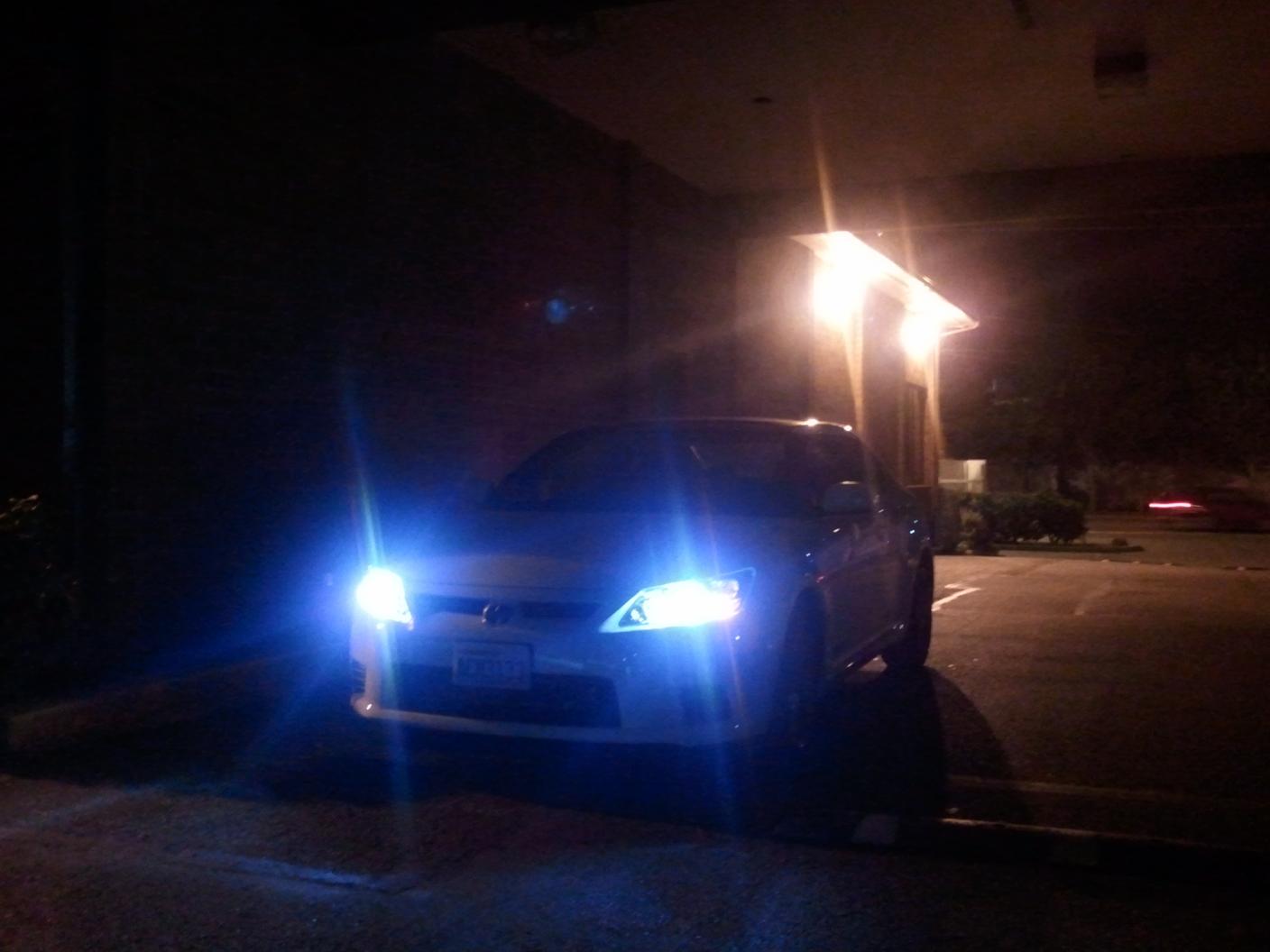

anybody else got hid on their tc2?
for some reason the cut off line doesn't seem very clean and has weird shapes... just wondering if anyone that has hid have similar opinion
i'll try to post something that shows the cut off line against the wall soon
but IMO it does look much better than the stock halogens...
any suggestions?

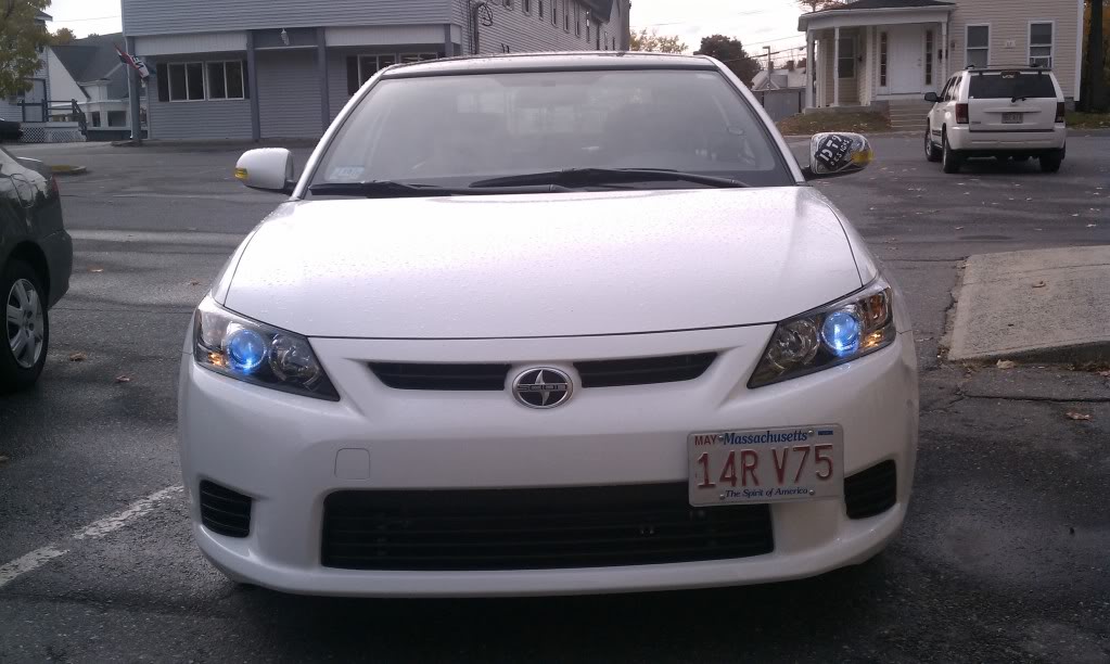

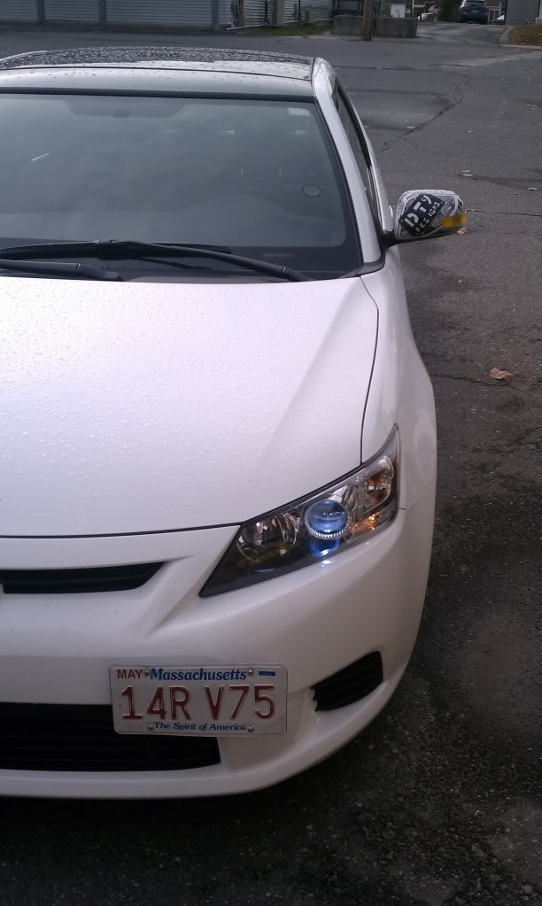

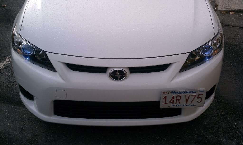

I have 10,000K's in my tC2

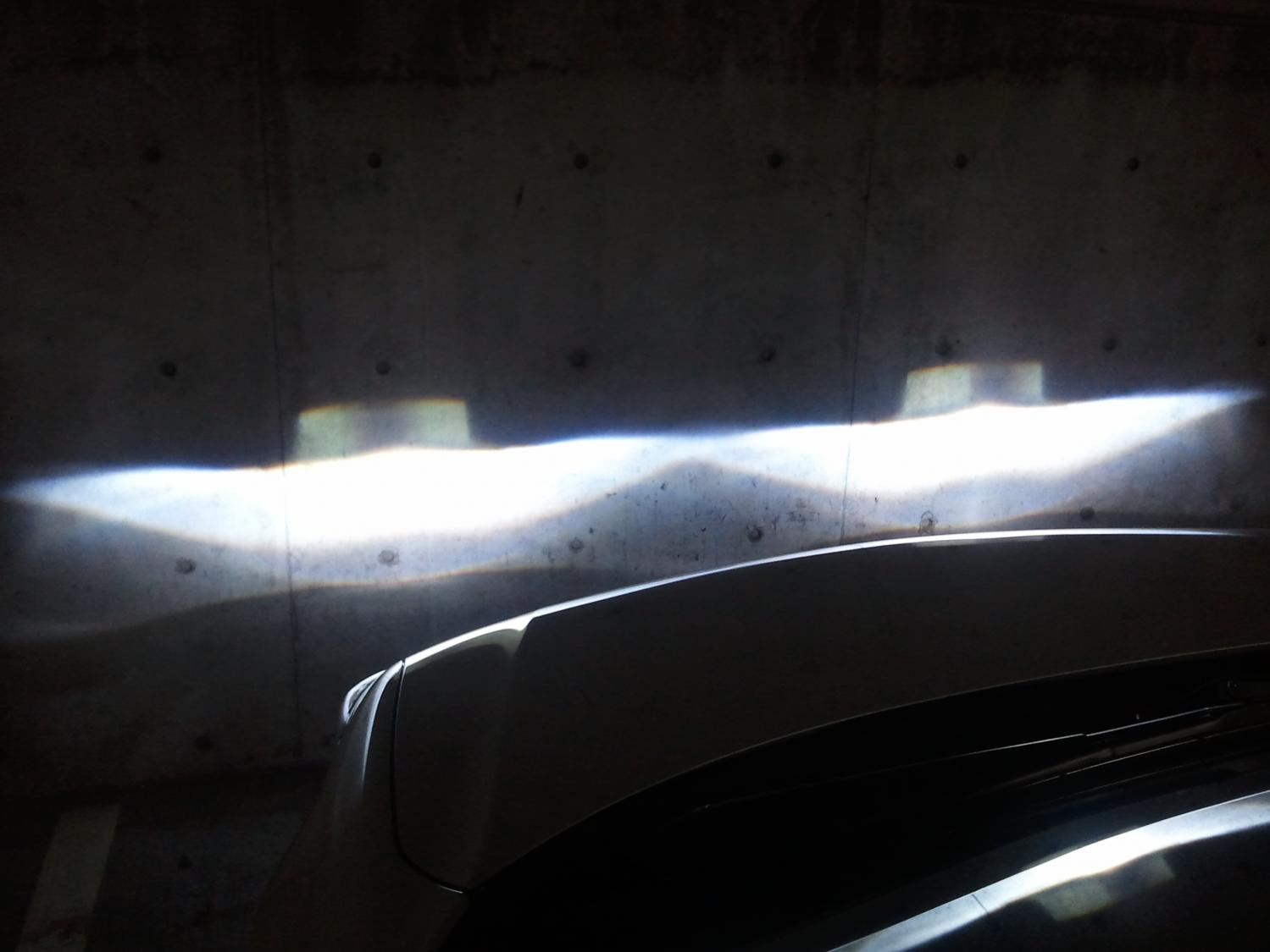

cut off line

My cut off lines look exactly the same... not sure why the wierd "boxes" show up, but they were there with the factory halogens too...

Cool i was just wondering if anyone else's looked different.. and what that box is and if theres a way to get rid of it...

Since these projectors are designed for halogens and not a true HID, there are 2 metal plates to reduce glare inside the projector itself. If you take out the headlight and look, you can push that plate a little bit to fix it, but it's not too bad of an issue. It's the same way in my Camry and we've dubbed them "squirrel blinders". No issues with oncoming traffic w/ HIDs for me, so it should be ok on the tC as well.

To add on to this, it's mainly used to light up the road signs.
Halogen projectors and HID projectors are two different type of projectors and again the halogen projectors isn't really suited for HID.
