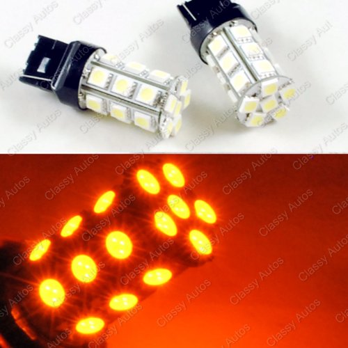

Front and rear turn signals are 7440 amber 24 SMD LED
reverse bulbs are 921 LED
brake lights are 7443 DUAL FILAMNET
city lights are T-10 194 LED

Don't buy bulbs with large heads for the turn signals because they wont fit in the housing.
