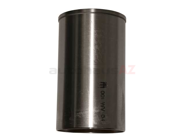

Sleeves have been done for over 100-years, so they're no secret, Rolls Royce sleeves use to be hot item, now many other vendors provide flanged sleeves to make it extremely easy. Many early alloy engines used flanged steel sleeves and can be replaced easily if you've got a tuning mishap and blow headgasket and scratch up your bores. I usually install with sleeve about 0.05mm taller than deck so there's extra clamping pressure. I'm sure Papadakis can figure out why factory cars don't drop their sleeves while his does.
Autohaus - MB sylinder sleeve
