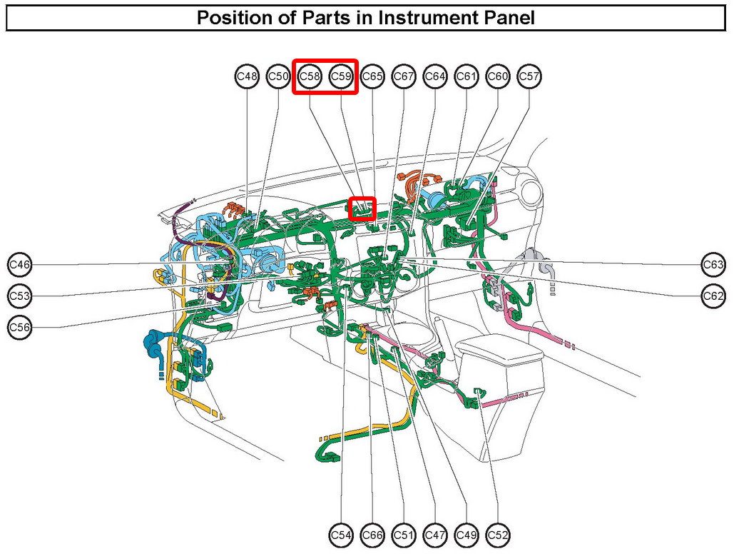

For the tC2 it looks like there are two junction connectors in the interior that carry the speed sensor wire (SPD). The manual tC2 has a purple SPD wire that goes from connector C58 in the interior to the ECU, and a light blue one that goes to C59. C58 uses a purple wire at pin 7, and C59 uses a light blue wire at pin 6.
Connectors C58 and C59 are both located in the interior, you'll want to find where this is. It's possible you could disconnect either one and try out the rev hang fix without cutting any wires, depending on what else is routed through the connectors.
Here is connector C58 (C59 looks exactly the same).
From here you should be able to install a switch fairly easily.
