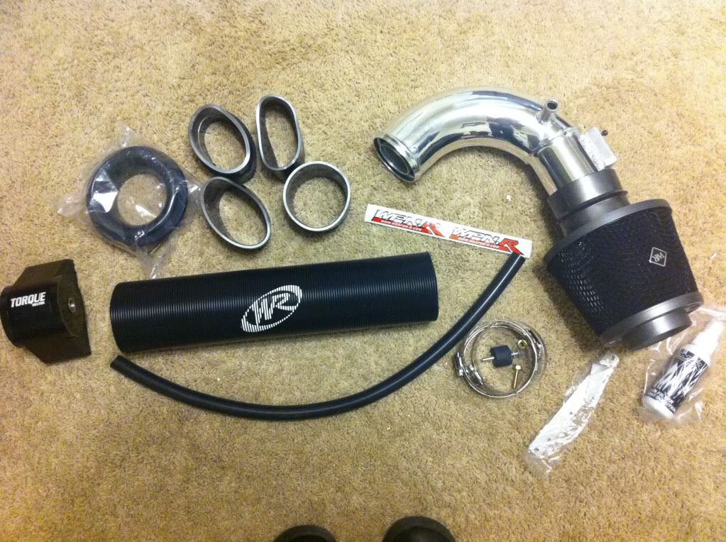

and someone asked what the intake looks like...

jtk2, did you use the stock breather tube or the weapon-r one? and the question from before: did you use a mount for your intake? if so u got a pic?
As I said, injen isn't the only one that tricks the maf sensor. The weapon r short ram and many others do the same thing in a diffrent way.
Injen uses a tube, and weapn r reduces the diameter where the maf sensor goes.
As you can see with the weapon r sri intake the maf section of the pipe is still smaller than the rest of the tube. You are still tricking the maf one way or the other. The design near the maf sensor is their for a purpose. That section or the diameter is exactly the same size or very close to the oems tube size so it can maintain the fixed amount of air flow that the oem sensor and the stock ecu can sense.
The tube in injens intake is right where the maf sensor is because it is collecting that air and that air only to give your factory sensor the correct or near correct amount of air flow.
Ask yourself this.
Why didn't weapon r keep the same size diameter throughout the whole tube?
Why right near the maf is there a reduce in size?
Because it is tricking the maf sensor that's why
