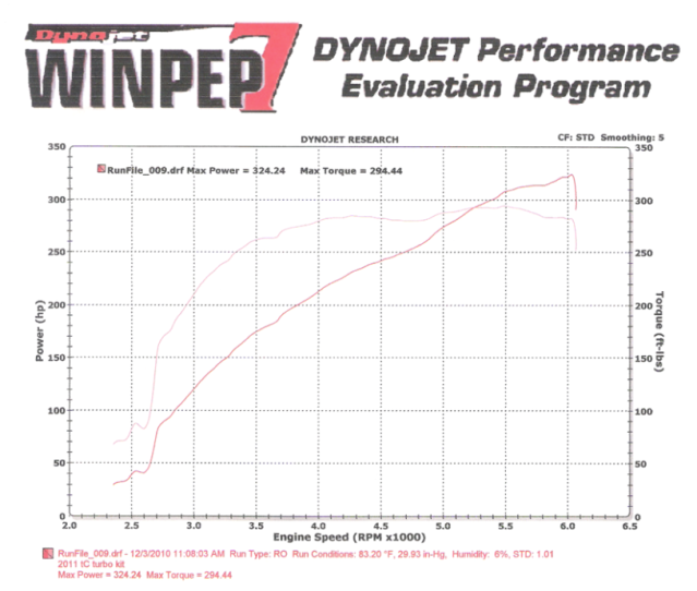

On the dyno she made 282WHP on PRE LOADED TUNE!! After 3-4 more pulls we got her to a safe 324WHP & 294TQ
