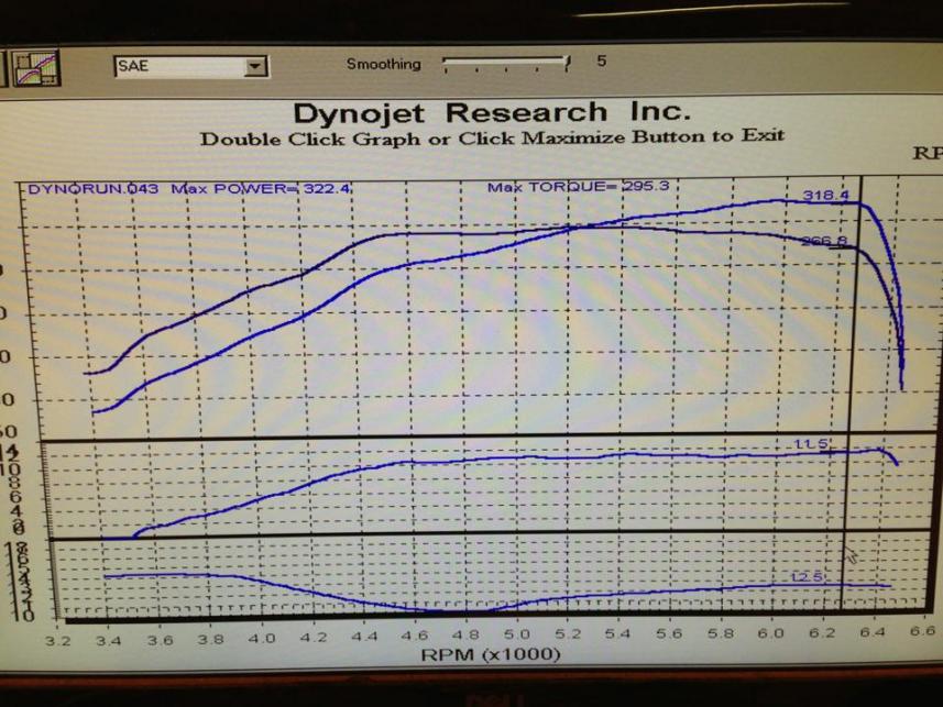

Sooo...last fall...stock exhaust with Dezod kit on 9.5lbs yielded 288/275.
Earlier in April..added the Dezod 3" exhaust and pushed 11.5lbs, which yielded 322/295. Not too shabby. I'm content for the time being!

34whp gain from our 3" exhaust.......Nice!
Thumbs up! 322/295 FTW!
What are the numbers on 9.5lbs?
An check engine light, codes?
He already answered the boost question. CEL, he will have to respond. Only one I can see if from no cat should be all he has.
Thanks, Paul.
What i meant was the hp/tq gains with dezod's 3" exhaust on 9.5lbs of boost.
And any recommended hi flow cat that can accomodate your kit? I would like to avoid having CEL codes.
He picked up 34whp due to the system creeping an extra 2 PSI
As far as cat, without relocating O2s and such, there really isn't a ton of room to offer one in the setup.
