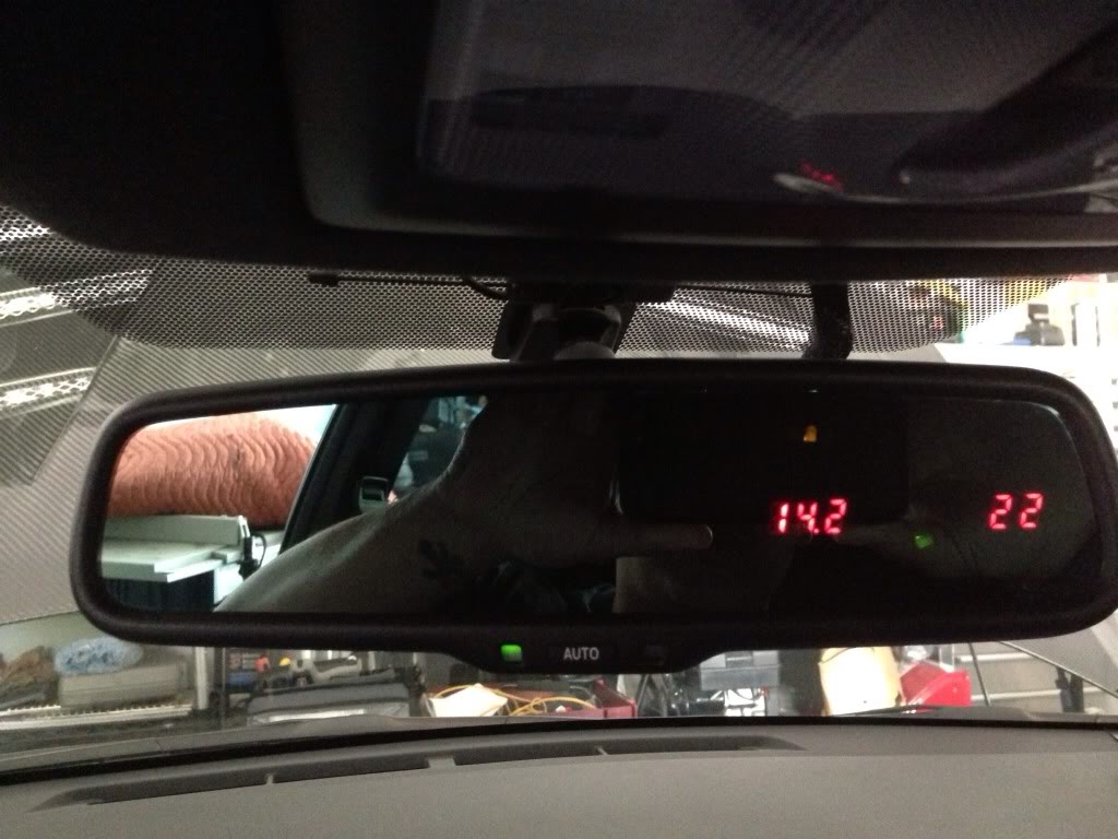

I'd get a wideband gauge from the get go when installing. Heres where i put mine.
Mike's install is the most slick I have seen for the TC2^^^

Replacement mirror? I kinda like having mine visible. I recommend your dash pod to everybody. But yeah it's not exactly hidden
