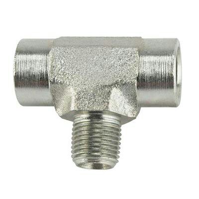

Found this on ebay
Would something like this work?

Originally Posted by Tc13
Attachment 14802
Found this on ebay
Sent from " NOT AN iPHONE "
yea,but you might have to get another male to female fitting,something like this..
http://www.etektuning.com/42-draft-m...emale-adaptor/
bascially,that fitting will go into the engine block,then that t-fitting male side,would screw over in the female portion of the fitting you put in the egine block,

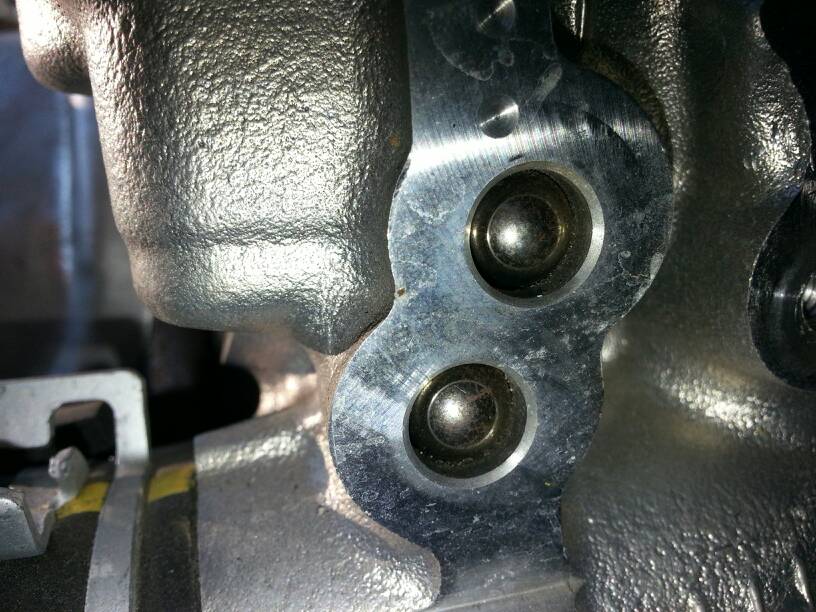

Got a fitting. I looked under the hood and I dnt have a sensor like that in my head.Oil pressure gauge-uploadfromtaptalk1374187543325.jpg
further back there is a sensor but I unhooked it and its water.
I'm not sure what this is looks like it could b a oil passage but I'm not sure how to get a fitting in thereAttachment 14818
Got a fitting. I looked under the hood and I dnt have a sensor like that in my head.Attachment 14817
for got you have the 2ng tc, its the sensor you have unplug,
i took your image and circled the sensor,gonna look up and make sure,its a 1/8 npt

Old Jul 19, 2013 | 03:23 AM
Tc13's Avatar
Joined: Oct 2012
Posts: 366
From: West Viginia
The one u circled is water I unscrewed it and water came out
Old Jul 19, 2013 | 03:19 PM
my06tc's Avatar
Posts: 2,992
o yea,thats weird,i looked up the oil pressure sensor,and it looked exaclty like that,unless its the sensor on top of the valve cover,next to the hose...
