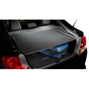

Where can I get this Cargo Cover? dealer discontinued them it seems from what they say.
I don't want this...

Well I want one, guess il make one. What's a good material for stiff/rigid yet resilient material?
Old Sep 10, 2012 | 01:03 PM
blktc2's Avatar
Joined: Apr 2011
Posts: 72
The factory spare tire covers use something close to this, commonly referred to as Masonite or hardboard: http://www.homedepot.com/h_d1/N-5yc1v/R-202088786/h_d2/ProductDisplay?catalogId=10053&langId=-1&keyword=hardboard&storeId=10051
Basically it's pegboard without the holes. Then just cover it with speaker carpet and add the hinges like in your pic. You might want to get some big pieces of cardboard first to use as a template so you get the dimensions and the curve just right.
Post some pics if you decide to take this on.
