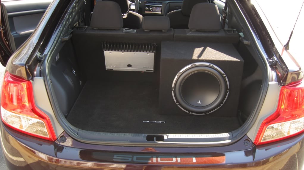

Here's my setup. It's a 12" in a 1.25 cubic foot box. I don't really feel like I'm missing out on too much trunk space. Your box would be an inch or two smaller.

I just checked the specs for the 10" Type R...optimum sealed enclosure is .6 cubic feet gross.
You could and should go even smaller and cheaper:
http://www.sonicelectronix.com/item_...0.7-Black.html
