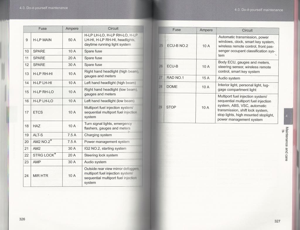

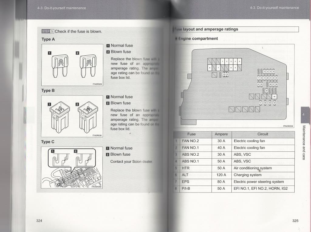

these should help, bud. check fuse #28 (small 10 amp fuse) under the hood. hopefully it's blown...
if it is blown, pull fuse #10 out (a spare 10 amp fuse) and use it for #28.

Alright thanks so much I will check that out right now!!! Painted my two front wheels and installed my HIDs while I was waiting for a response it really makes a difference in the car!!
