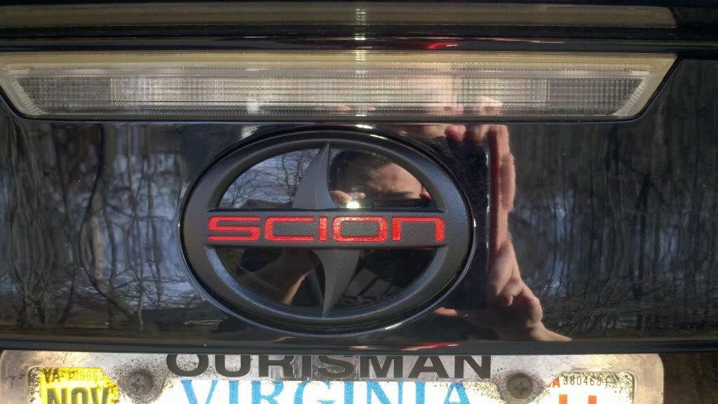

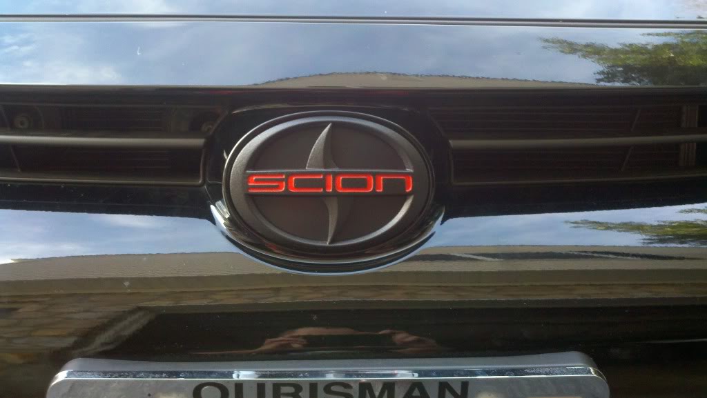

Painted my emblems and dash during Thanksgiving break
Front Emblem

I know black and red is played out but I've always liked the combination.
Pics are crappy, they were taken with the cell phone.

looks good, how did you do the tiny lettering?

The painted interior plastics are a little too ricey for my taste, but that's def the best painted emblem job i've seen yet! Care to give us a few tips? I want to do mine the exact same but gold in the middle instead of red

The way i painted it is going to sound weird but you can obviously see the results from it. Instead of using a brush of any kind, I used a toothpick and model paint. Toothpick, because it was the only thing in my house that i knew could fit in the letter spaces. I dabbed the paint onto each letter and did 3-4 coats each. Letting it dry for a day, i went back and clear coated with model clear coat using the same method.

Dang that's really interesting, I've never heard of it being done that way! I don't think I have enough toothpick skill to do that without getting big globs all over but congratz! Job well done

What kind of paint did use for the black on the emblems? And great job it looks awesome.

i used plasti-dip for the emblem itself
