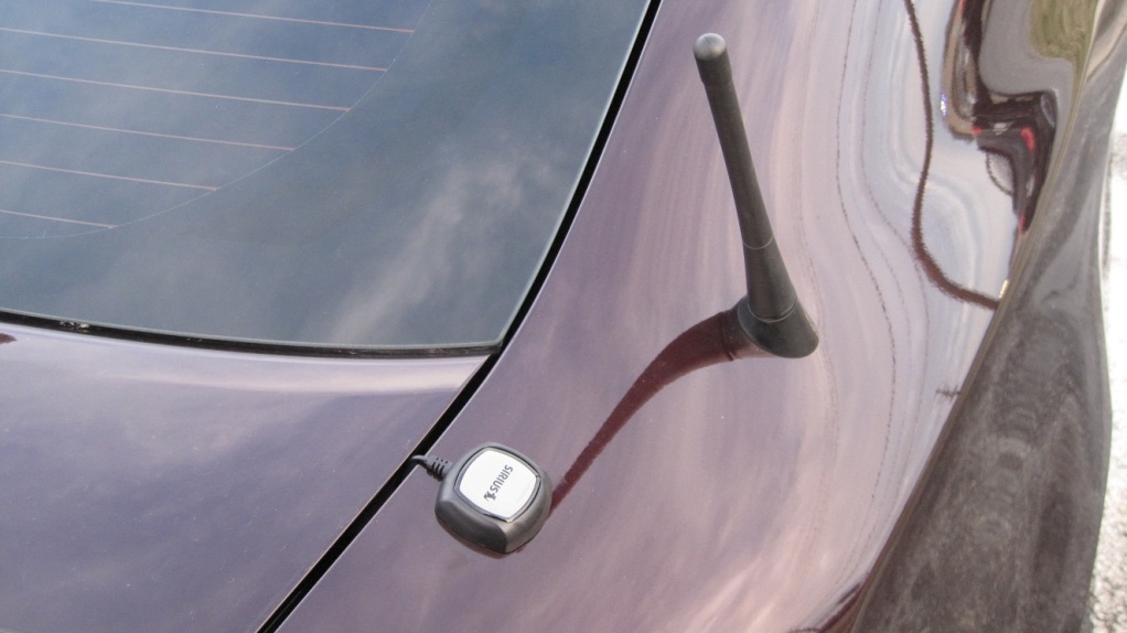

I went this exact route as well. My install took significantly longer than 20 minutes though because I installed it the way it SHOULD be installed, placing the antenna at the rear of the car like your dealer would...
I wasn't exactly blown away by sound quality though. In my opinion, it sounds like low-bitrate MP3 music. The volume level is low as well. I cancelled my subscription and now strictly use my iPod.

Best buy wont have the direct connect kit to go on your factory stereo. You could get the aftermarket equivalent or get a portable dash mounted unit. How do I know? I am an installer for best buy.
Best option if you wish to retain the factory stereo is go with the factory option for xm, go with the scc1 and sirtoy for the sirius option. Only real difference being your sports lineups and howard stern. I would recommend going to the xm side of things as in the future sirius will be phased out and it will be primarily xm. If you plan to have sat for a long time that would be the smart move from someone who is on the install side of things.
Sound quality wise I don't know how you can say it sounds like low bitrate music.. it will be no worse than a download from iTunes as they use anywhere from 128kbps-384kbps. Depending on how you have your satellite hooked up (fm modulated interface or *shudders* the casette tape) you may experience major quality loss. FM modulation will cut of a chunk of your high and low frequency sounds and cassette tapes.. well there is a reason they are not around anymore.
And fyi that is not how a dealer would install your antenna. I would definately not do it that way. See if my buddy 1293RS7 will shoot you a pic of his antenna where I installed it. I avoid putting the antenna on a metal surface if at all possible without double sided tape to avoid scratches which WILL occur from moving around.
And I would not exactly hype up dealer installed equipment.. most of their "certified techs" can swap out and engine and fix many issues but have no idea about anything audio/video related and their solution is to either blame the equipment as faulty, blame the installer or just throw new parts at the car until the issue goes away. And don't get me started on their use of t-taps on alarm and remote start systems.
