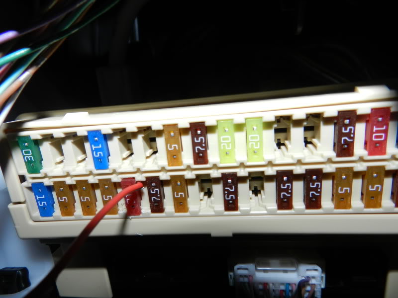

I wired mine into my headlights, so whenever I turn my headlights on they come on as well. If you know where to wire them it's really simple. It took me 2 minutes to wire them and about 5 to mount the lights and hide all the wires.
This is where you plug the red wire, you must also ground the black wire to a screw or bolt.

WIXO thanks for that explanation. now quick question, from that picture with the zoomed fuse box do you think you can tell me which one is the dome light one?

I actually just did mine tonight. I tapped into the exact same fuse as Wixo, though I did use an add-a-circuit. It took me like an hour and a half cause i wanted to completely hide the remote that I stuffed under the center console. It looks pretty good if I may say so. My ground wire is the cigarette lighter.

hey man, awesome pics. you have a complete DIY? what's that thing there? the control for the lights?
John, I just checked the manual and they didn't show any fuses for the domes. However, you can double check the manual again, it's on page 329-330. Btw, fuse I used is number 16, listed as "tail".
Not yet, this write up was thrown together in about 20 mins.
But if I have any time I will definitely write up a full diy, just gonna be busy the next couple weeks (Cali and stuff).
and yeah the black/white/red box is the control for the lights. I usually keep them on and just activate them with the headlight switch.
