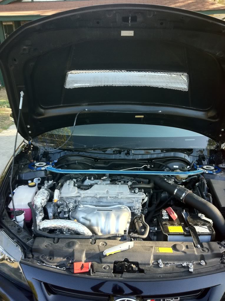

DESCENDANT CAI:
I have about 1 finger clearance no squeeks, vibrations, or noise.

thats clean man. i think even more clearance than mine...weird we have the same setup
any modifications?

i think i know what he did. so he put the washer first, then the blue pieces. then the bolts. am i right mr. black mamba? i just thought
of that yesterday. will do it on friday.
Old Oct 27, 2011 | 03:16 AM
  #292
Backinblacktc2's Avatar
Joined: Jun 2011
Posts: 1,007
From: Texas
Yes I did. I also removed the screw with the rubber that came with the descendant intake and put the oem screw with washers to sandwich the tab that protrudes from the lower part of the intake to alow the intake to move with the engine.
