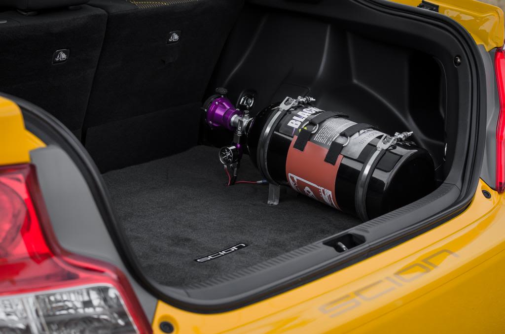

Honestly this car has never seen a drag strip. The nitrous is simply there just to have fun with. So far it has been thru 1 10lb bottle for testing purposes and 2 races but that's it. Don't really ever use it. I don't promote street racing but I'm not gonna say I've never done it. I keep 99% of my racing on the track but there is that 1% where sometimes you just get caught up in the moment or a buddy is wanting to compare the performance between 2 cars.

I have quite a few questions about that zex kit if I can pick your brain. How long does it last with hard driving ? What did you do for the tune ? It says on installation guide it needs to be tuned somehow if you use more than the 55 hp setting. Seams very vague. They don't say ecu tune or not controller tune. Where exactly did you install the injector on the intake ? Some detailed pictures would be great too. Really thinking about this for screwing around at track. Seams like bang for buck is massive with this kit.
Old May 27, 2014 | 09:49 PM
a-mendoza's Avatar
Joined: Aug 2008
Posts: 868
From: Amarillo, TX 79109
1.) How long it lasts depends on how long you use it for. The kit comes with a 10lb bottle and with a 75shot is good for about 10 full 1/4 mile passes. You may be able to squeeze and extra pass or two before running dry.
2.) There are two things to tune on the car. 1 is "AFR's" and 2 is "Timing". The guys at Zex have already eliminated the AFR tuning for you. As long as bottle pressure is between 900-1000psi then the jets that are recommended for the fuel and nitrous supply will work perfectly so no swaping out jets to adjust AFR's is necessary. As for the Timing, the only way to change that is with a tuner of some sort like a Unichip, AEM F/IC, EMS, etc. I personally have a Unichip in my car but have found that leaving the timing alone for the 75shot is ok. So no timing adjustments were necessary so realistically I dont even need the Unichip to run nitrous. I could just bolt up the kit and go. They say to take away 2-4degrees for a 75shot but thats just a rule of thumb like taking away 1degree per pound of boost on turbo cars. The end result is what you can push without knocking/detonation.
3.) As for the nozzle, its mounted right after the MAF sensor and before the throttle body. The nozzle is were both the nitrous and fuel line combine and spray the proper mixture down the intake stream and finally into the cylinders. If you look closely you can actually see the lines and nozzle that are going into the intake pipe after MAF sensor. on my second to last pic.
If your interested i happen to have an extra Zex nitrous kit up for grabs that is brand new. LMK if your intrested.
