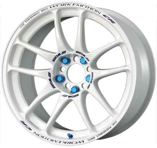

want to ask about what offset with fit My tc2? im thinking about 18X9.5 +30 for front, 18X9.5 +20 for the rear(hellaflush)thx!

Stock offset is 39... I would stay close to that. 20-30mm offset in a rim that wide would probably rub on the inside. Check the wheel's weight before you buy. Stock wheel is like 27 lbs. Anything heavier than that is going to rob you of power and fuel economy.

Ill post these pics again,
They are actually the ROTA version of the WORK CR-Kai, 18x10 et +20
Originally Posted by greenbean24
Test fitted one of the wheels my buddy runs on his Evo X,
5x114.3 18x10 et +20 245/40/18
not that aggressive, definitely could fit more with stretch/poke/slam
I think your sizing is pretty close, not real aggressive, but would put you out to the fenders.
I know youre thinking staggered fitment, but also the front wheel wells are big on the tC2, so you might be able to just order all 4 wheels one size and still be able to rotate them front to back. (just a thought!)
Im not sure we will have a whole lot of info on here until someone is slammed and test fits and buys aggressive fitting wheels.
Later,
Austin

I also was checkin out the sizing for the CR-Kai, and it looks like the 9.5j is the widest they sell, that sucks
At least you can get it in +12 offset

yes.i was also thinking get all 4 wheels in one size. thanks! you have any suggestion about the Suspension? QUOTE=greenbean24;3778421]Ill post these pics again,

if i put +12 ,i think the camber at least need to adjusted to -4 , that is not gona happen in Montreal, the road condition is so bad. lol
if you want 10 try the work XD9! looks nice
