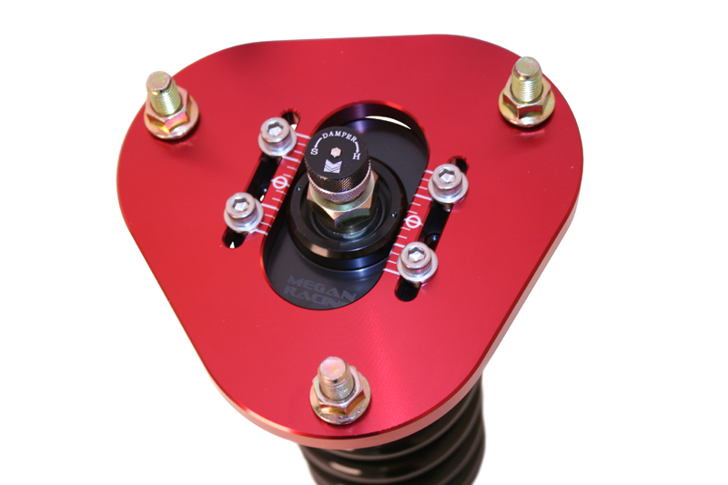

Megan Racing just released their coilovers and are available for sale now.
Specs:
SPRING RATES:
F: 62mm ID; 180mm length; 6 kg/mm
R: 62mm ID; 175mm length; 6 kg/mm
MIN/MAX DROP: 0-3" ALL AROUND - can ride at stock height if desired!
DAMPER SPECS:
F: 120mm stroke; 280mm length; M1 valving code
R: 175mm stroke; 280mm length; 44R01 valving code
- 32 Levels of Damper Force Adjustment
- Pillow Ball Upper Mounts w/ Front Camber Adjustment
- Rubber Dust Boots
- Adjustable Ride Height
- Aggressive Spring Rates
- Single-Cylinder Design
- Aluminum Brackets
32 Levels of Adjustment:
1-8: Suggested for track use.
9-16: Suggested for mountain/aggressive use.
17-32: Suggested for common street use.
- All coil-over damper kits come with 1 year manufacturer-defect warranty.
- All Hardware is Included
MSRP $1000
Megan Racing Coilovers for Scion tC 2011+

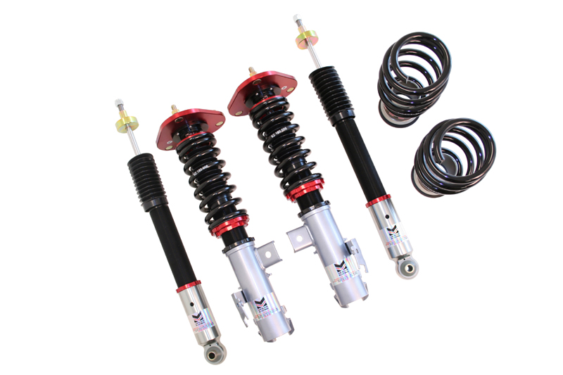

I really can't tell fron the photos, but it looks like the rear springs are installed in the stock position and therefore not a real coilover. If so, then how is the rear ride height adjusted?
Old Jun 23, 2012 | 05:49 PM
CementTC's Avatar
Joined: Apr 2012
Posts: 241
From: Front Royal, VA
Looks like they are but have that piece with the locking collar connected to it and the spring sits on that so you just spin it up or down to raise or lower.. My cobalts coilovers were like that.
Basically they're like this http://youtu.be/-1e85NOrZks but supposedly we cant adjust ours like this because they sit in a cup.
You are right - the springs are separate from the shock, as are all coilovers for a rear separate spring designed car. The pictures above are the real Megan Racing coilovers that are for the tC2 (it is not a generic stock picture).
CementTC is correct - you spin the locking collar piece for the rear setup to adjust the height.

Then could you double check the spring rates...I think there is an error. If the rear spring goes into the OEM position, then the spring rate should be about twice that of the front for optimum handling.
Old Jun 26, 2012 | 06:07 PM
Bean_Garage's Avatar
Joined: May 2009
Posts: 2,791
From: Jacksonville, FL
They are the correct rates - I verified with Megan Racing.
Also, the coilovers were tested off the OEM suspension. They upped the spring rate compared to the OEM springs and used the weight of the car to come up with their spring rates.
