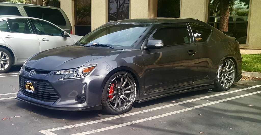

19's will fit here is my set up 19x8.5 et45

Whoa! Thats badass! What wheels are those? Is youre car lowered?

They are Gram Lights 57XTREME SP SPEC

any chance we can get links for the side skirts and front + rear lip?
