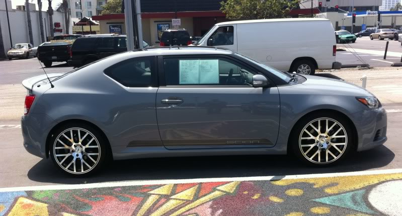

TSW Donington
Front: 19x8 (et35)
Rear: 19x9.5 (et35)
TRD Lowering Springs

What tire sizes did you go with?

Those wheels do look real nice, but our choice in size leaves a lot to be desired. Not having driven your car, I bet it under steers drastically now. Cars are designed with under steer to begin with and then you gave the rear even more traction than the front by installing wider wheels in the back than in the front. For performance, staggered wheels are NOT the way to go on FWD cars...
I've got 19X9 with 40-mm offset (all the way around)...and there was very little clearance in the back to the drag link...what kind of clearance do you have there with your setup? Include tire make and size...Thanks!

One more thing…if you don’t mind. We would like a gauge of the quality of your wheels…
As a rule of thumb...a good indicator of the quality of the wheel, is how much weight was used to balance the wheel. What is the total weight (count both sides) used to get the wheels in balance?
Again...I like those wheels...

The tires up front are 225/35/19 and the Tires in the back are 255/30/19
All 4 tires are Kumho Ecsta SPT's
I would assume that the difference in size and offset on our wheels would make the rear clearance about the same. Here is a picture that I took with my phone. tCclearancerear.jpg?t=1304717042
Here is another shot of the wheel set up from the rear quarter panel perspective. tC1.jpg?t=1304718165
A few more shots
