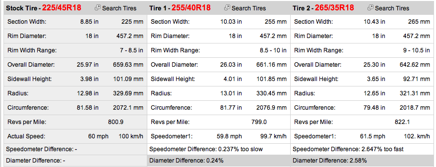

Originally Posted by 2tCornot2tC
Wrong! The OEM tire is 225/45R18 and Michelin makes a Pilot Super Sport in that size too. It rolls 802 revs/mile…that would only give you a 2.5% error from OEM so that is well within 5% allowable.
whoops. I meant 255/40/18.
Both are within 5% but the 255/40/18 is a better fit. And is CLOSER to OEM. Also where I live (DC), you're hitting potholes on the daily. A 35 wouldn't survive.

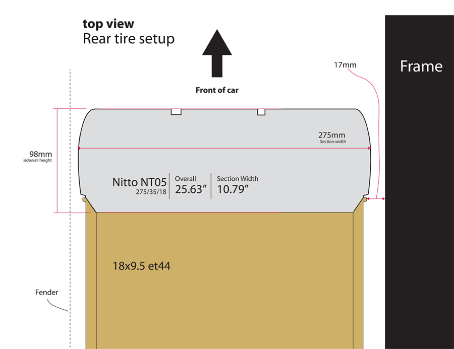

Ok, so Im down to 255/40/18 or 275/35/18. 265/35 is just a little short for me.
I went to the Nitto website and got all of the exact dimensions for the tire I want to run. Also, I crawled around under the car and measured points of possible contact. Then I drew everything to scale! Seems like these 275/35's should work. How much "wiggle" room do you need for tire flex? Also I wanted 2tCornot2tC to look over my diagrams and see if i missed anything!

I’m running 255/30ZR19s on 19X9 wheels with a 40-mm offset. Their section width is 10.2”. Since yours is 10.8” that means that your wheels are 0.3 wider on a side but you will be 4-mm closer inboard with your offset or 0.16”. Add that to the 0.3 you’ll get 0.46”. When I put my wheels on, it seemed like the closest spot was on the rear at the drag link. That is on the forward side of the upright that goes to the chassis. If I recall right, I think there was only about ½” there clearance on my car. You’ve used that all up. Even with the wheels that I’ve got, on a good bump, I would still hear a rub…I can’t see any traces of a rub, but I can hear it. That is only when the suspension is bottomed out on a bump or hard in a corner. The car is lowered on TRD springs.
This is what you need to do. Take off one of your rear wheels. Lay it down on the garage floor. Get a straight edge or a 3-foot ruler and lay it on edge on the sidewalls of the tire. Measure the distance from the garage floor to the bottom of the ruler’s edge. This is the section width of your tire. Since the OEM wheel is 18” and you are replacing it with an 18” wheel and both have the same diameters, the high spot in the sidewall of your proposed tire will be in the same place. Let’s say you measured 8-3/4”. The new tire will be 10.8 so your difference will be 2.05”. Divide that by 2 and you have 1.03”. The OEM wheel has a 39 offset and you will have a 44 offset or a difference of 5-mm. That is 0.20”. You need to add that to the 1.03” for 1.23”. Put your wheel back on and measure the distance from the high point on the tire to the drag link. If you don’t have 1.5”, then the tire/wheel won’t fit. Even at that, you will only have 1/4" gap...if you are only going low and slow, that is probaly good enough. 3/8" to 1/2" would be much better. These are low profile tires...they don't flex much.
Old May 11, 2012 | 03:30 PM
TankedPilot's Avatar
Joined: Dec 2010
Posts: 145
From: Sunshine State!
Well, it looks like I have some more measuring to do! I will take off the wheel and measure like you suggested, and check the clearance on the drag link.
