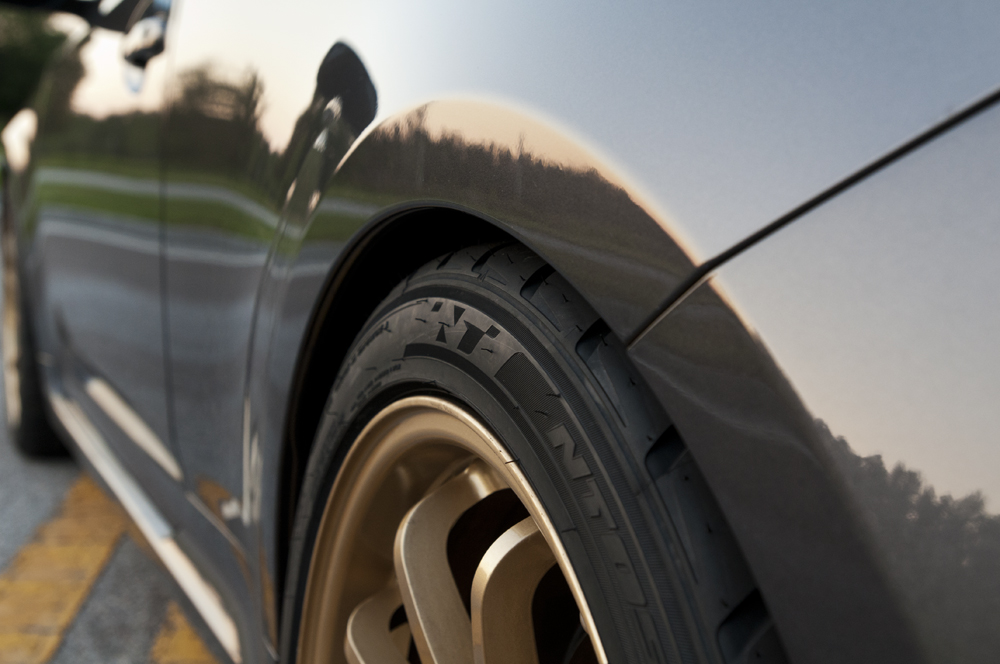

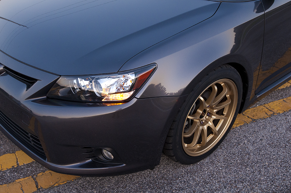

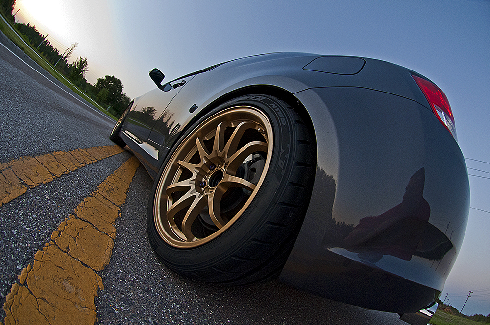

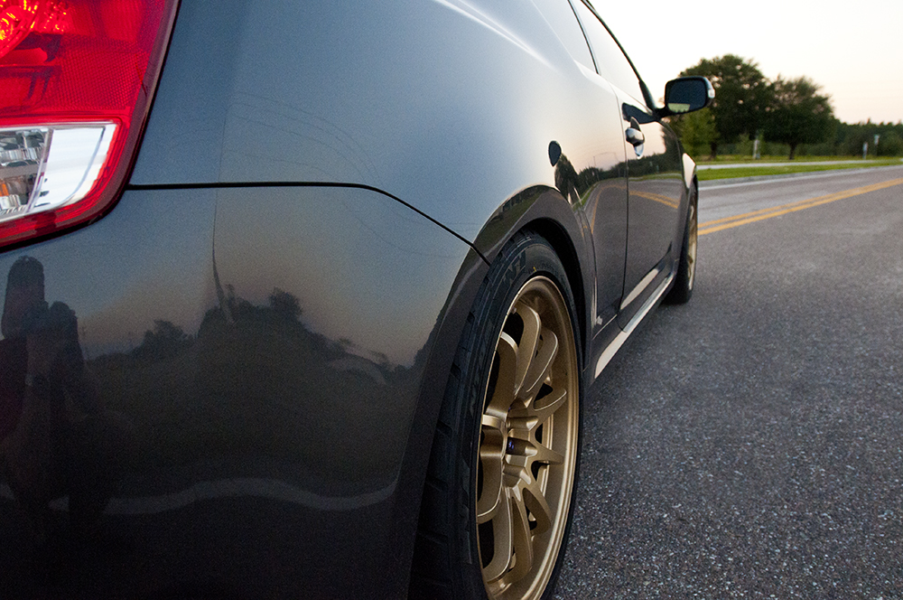

Liiiike a glooooooove Nitto NT-05 275/35/18
Got a 1 finger gap all the way around, no rubbing at all!

That looks sweet! Now we know for sure. That is a much better looking "proper" fitment...What's the new tires weight? Do they feel heavier?

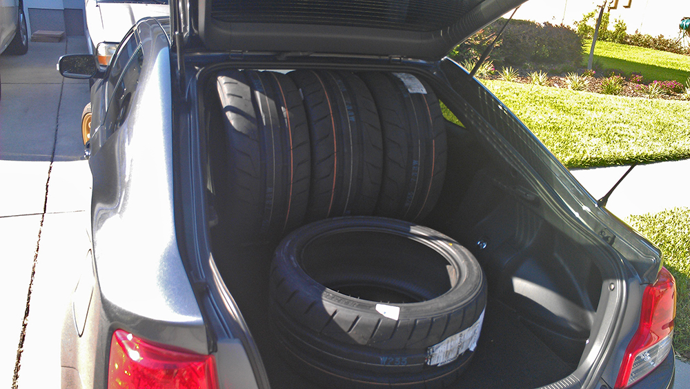

Thanks! Definitely the "proper" fitment I was looking for. New tire weight is 27.3 lbs, old tire weight was 21.6 lbs. So I ended up bolting on 5.7 lbs per corner. You can feel the weight, not really a big deal though.
Stock wheel and tire comes in at 52 lbs, my new set up is 48.3 lbs. So I am under the stock weight by 3.7 lbs per corner. It's kinda crazy how much larger my set up is from stock, and its 14.8 lbs lighter overall! I can live with that.
They fit in the back of the car nicely
