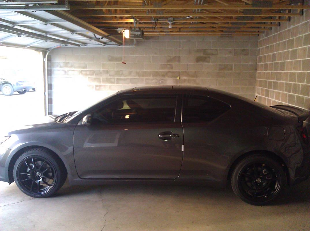

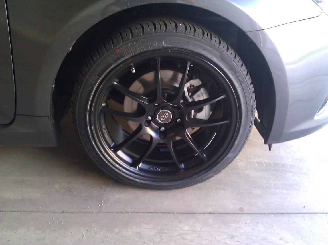

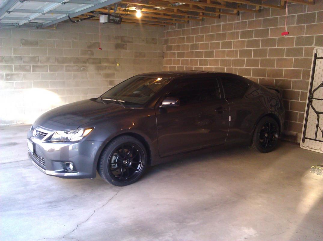

Just picked up my new shoes!!!!
Enkei PF01
18x9.5
+35 offset
235/40/18
Going to be dropping it this weekend on TRD springs. I'll post better pics after its dropped but for now, here's a tease.

Im liking the stealth look its getting. Needs darker tint IMO

nice rims.... cant wait for more pics lowered.

so sleek and stealthy! looks sweet. i think the drop will really set it off nicely

Needs the drop, but looks sexy already! Really aggressive fitment you chose there! Any photos of how flush?

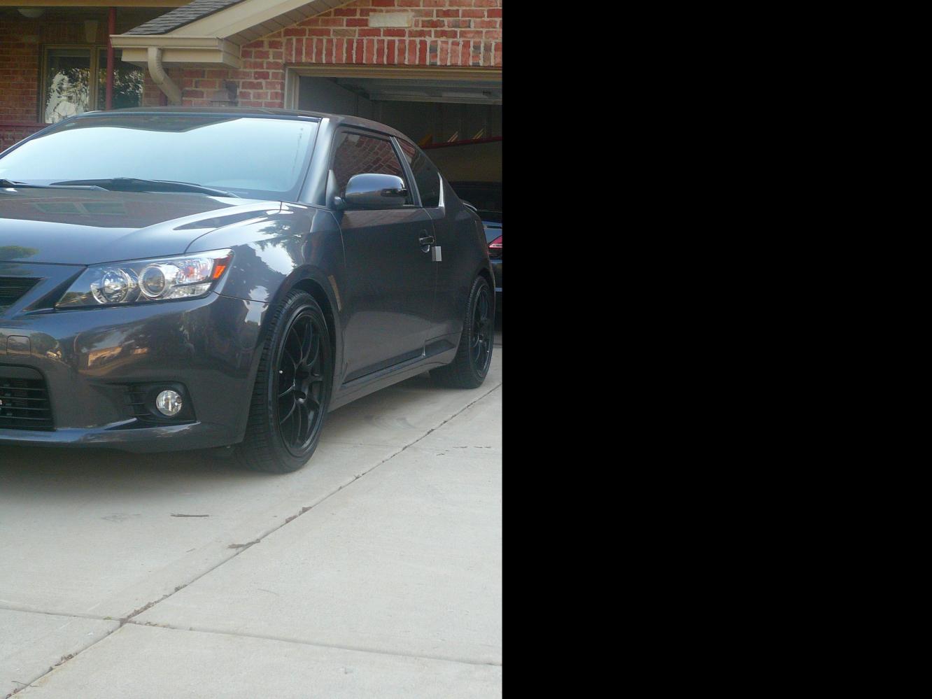

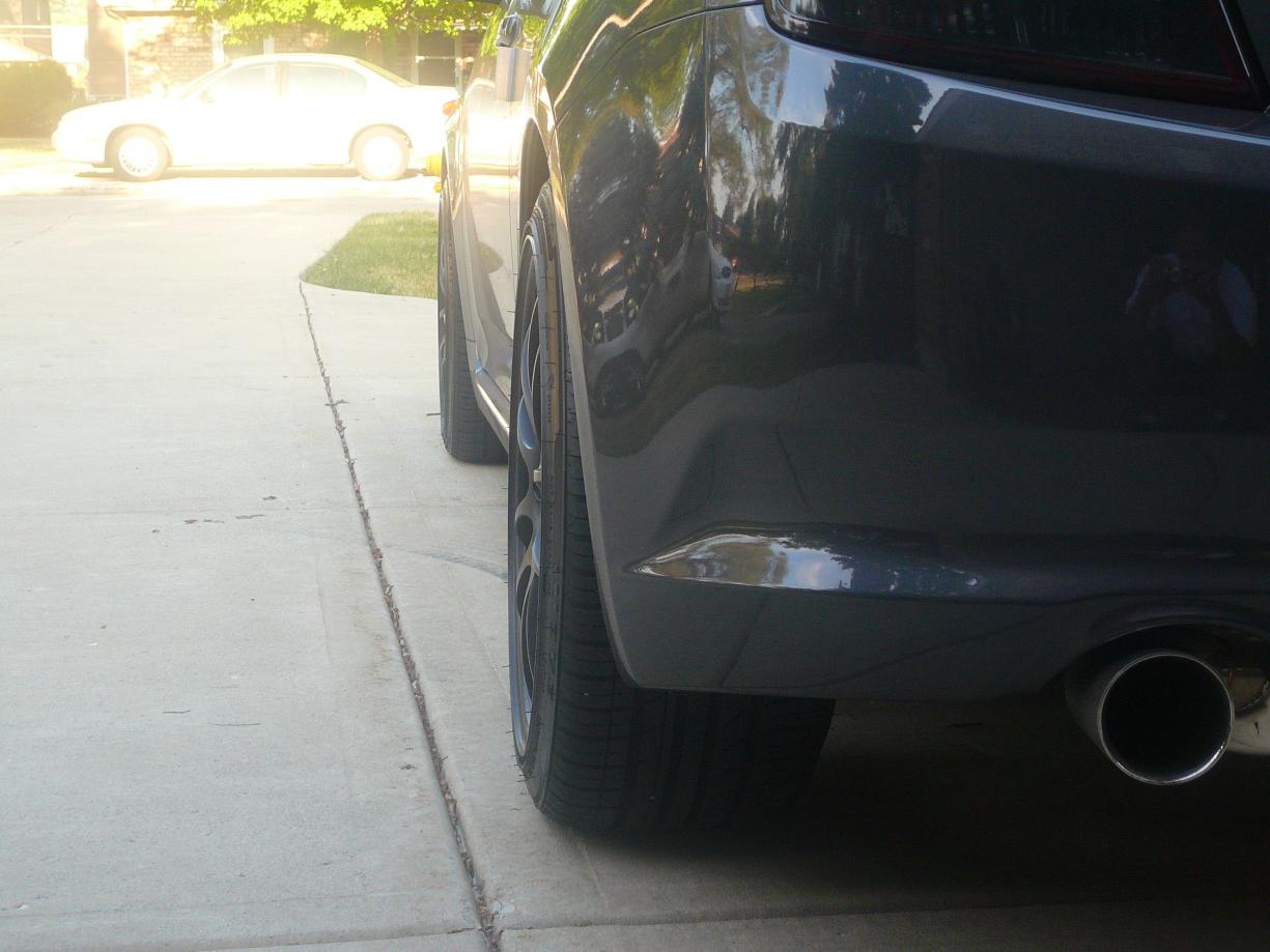

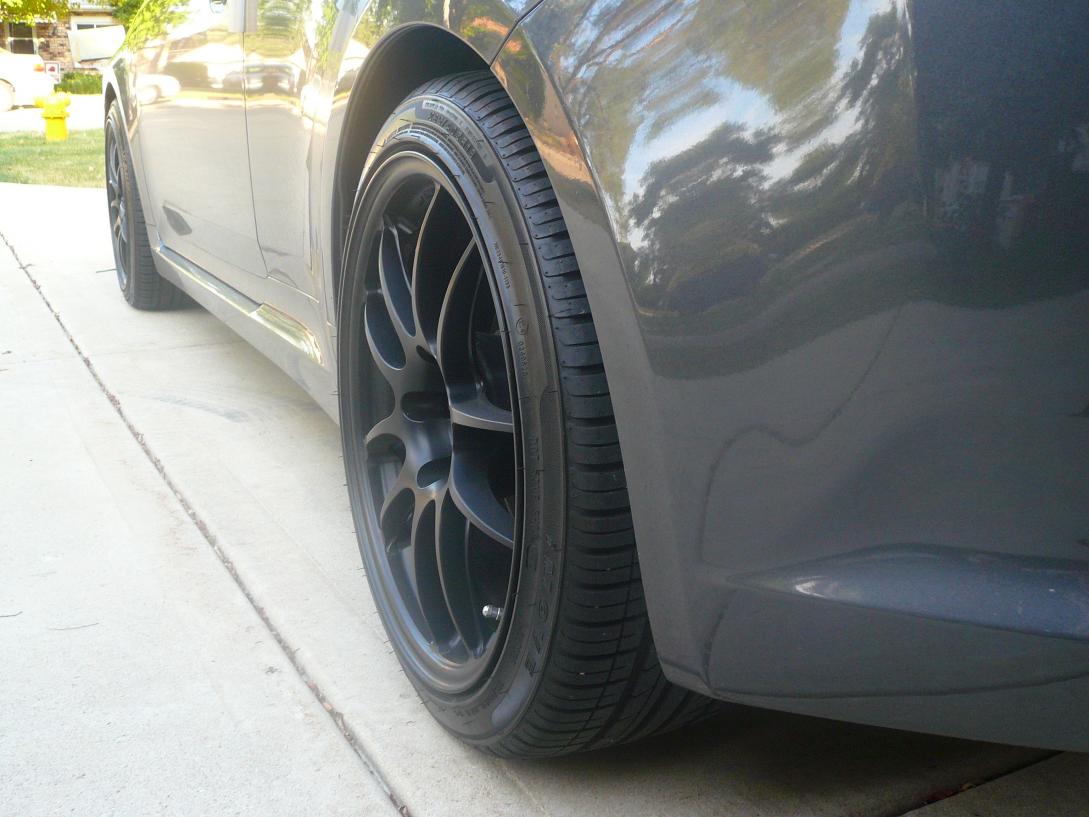

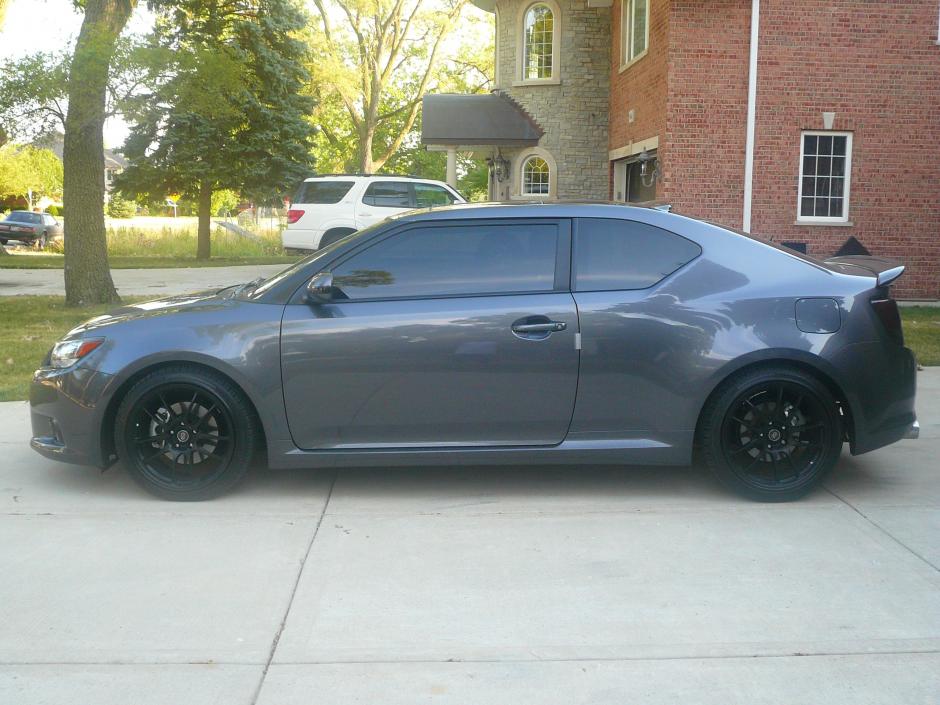

My apologies for the delay in posting after the drop, but here they go.

Those look sick! Same size I have ordered for my Tc if the car ever gets here.

To the OP, your going to have to base your decision on a number of things. Alignment settings, inner clearance, outer clearance, fender clearance, clearance to the bumper/fender when turning, etc, etc.
From the looks of things, your front camber is really not high enough to accept a wide tire. This is exactly what I thought might happen by going to a +35 offset, which is why I started at +45 and "shimmed" for what I needed.
In all honesty, with your current setup today, a 245 is probably the max you can run without altering the geometry of the car. If you go wider, your going to need camber up front which will make the car more twitchy under straight line acceleration and braking - not good if your boosting for straight line driving.
But measure and see. Like others have said, I have 255/40R18 Advan AD08's now and I know I have room for 265's at min. I want 275/35R18 though, but my worry is the same as yours: clearance.
