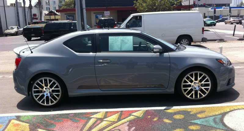

19x8 in the front et35 - 225/35/19
19x9.5 in the back et35 - 255/30/19

^ How flush are those I want right inside the wheel well? Anyway they look good and still with the sticker in the in the window.lol
Also the lug is 5x114.3 right?
That will depend on tire size, suspension setup, alignment settings, etc. What works for one person should be used as a guideline for others, not gospel.
For example, my tires are a lot wider than what kahsperr is running. Although we both have 255's on (I have them on the front as well), we are running a different type of tire which will change the stance of them. Track type tires naturally sit wider than street tires.
But yes, the pattern is 5x114.3mm.

tC1.jpg?t=1304718165
The rear wheels sit perfectly. I would have chosen a 32 or 30 offset in the front instead of a 35 if I could do it over again.

^ the back perfect. So I think the +38's will be fine if not I put spacers.
