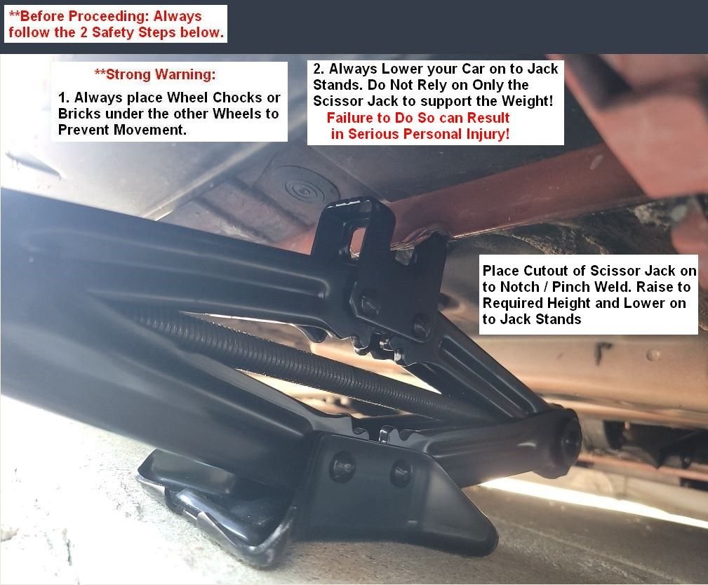

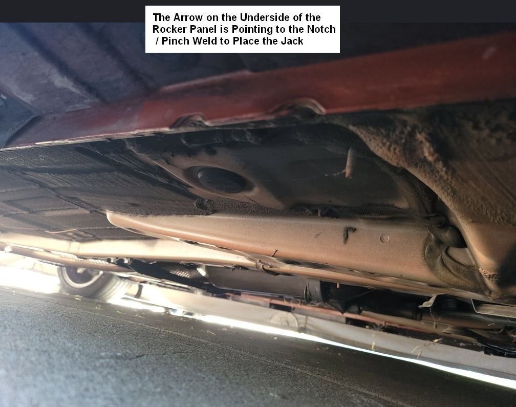

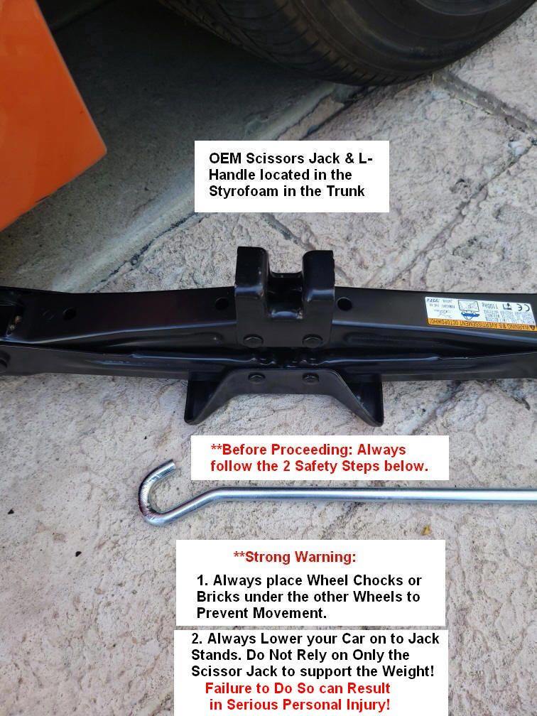

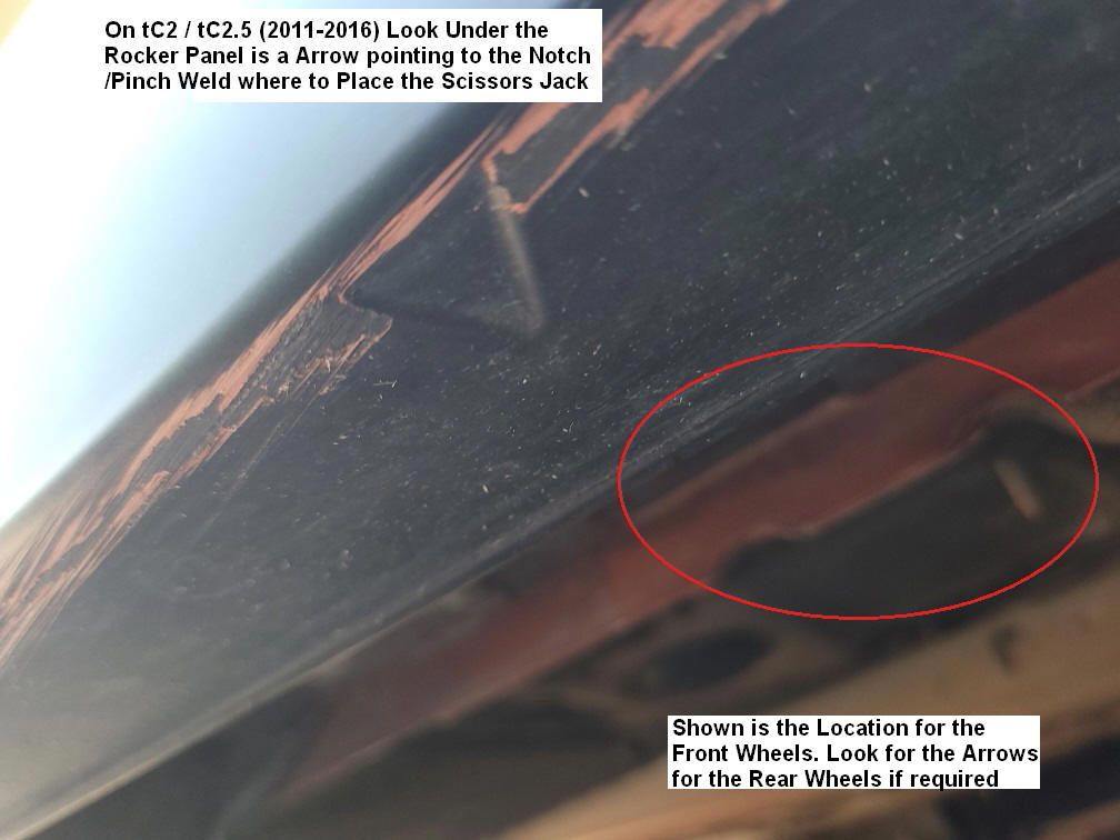

Place your Jack Stands pretty much as Shown.
** Warning: Always use Jack Stands as Shown. Whether using a OEM Scissors or Low Profile Floor Jack.
Failure to Do So can Result in Serious Personal Injury!
