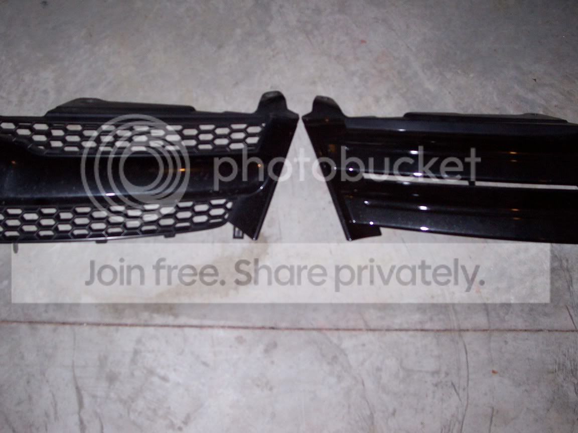

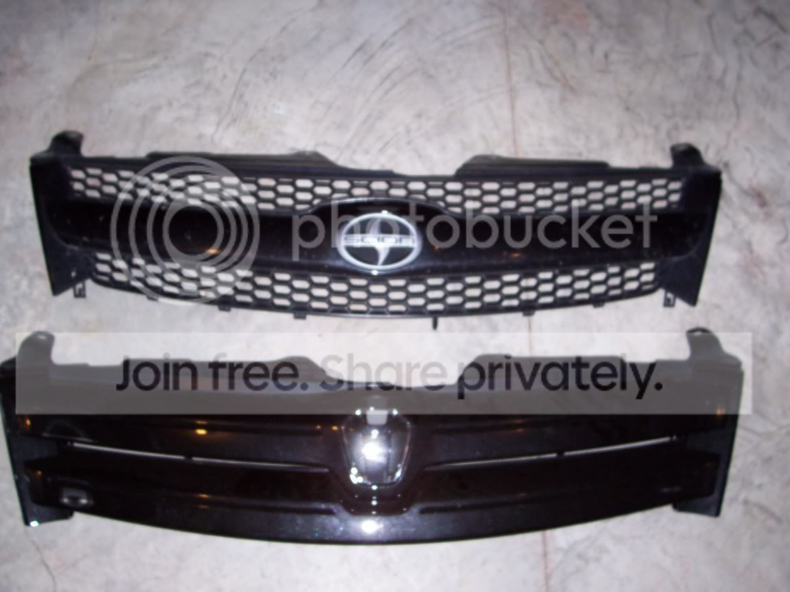

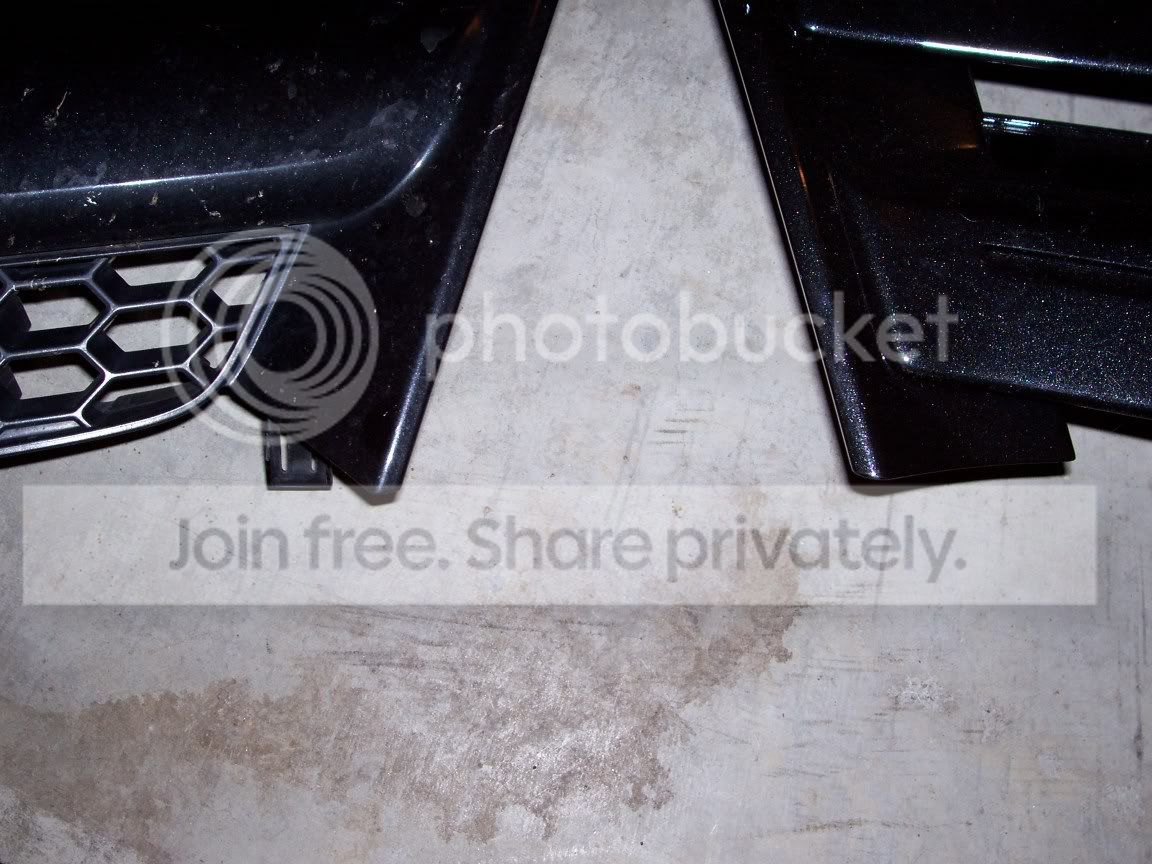

Tabs are missing on the bottom of the ist grill, and the angle at the bottom of the ends needs trimmed, but otherwise, it should fit, eh?
Old Jul 27, 2006 | 01:54 AM
mdtjr's Avatar
Posts: 177
From: San Diego
Thanks!!, looks like the us version has additional mounting clips.

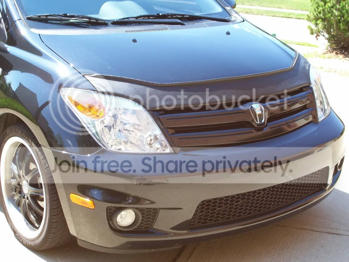

I trimmed it up, and made it fit. Since there was no mounting clips on the bottom, I drilled a hole in the bumper, put a grommet in, drilled a hole in the grill, and ran a black 1/4" bolt through to work as a guide, like the tabs on the stock grill. It works very well, holding it in place securely, although drilling the bumper was nerve racking! Now it's time to rebadge the rear to match the grill...I'll post pics when I am done.

Thanks for the tip illnist...that is a few weeks away, but for now, here is the new grill
Very happy with the look!
