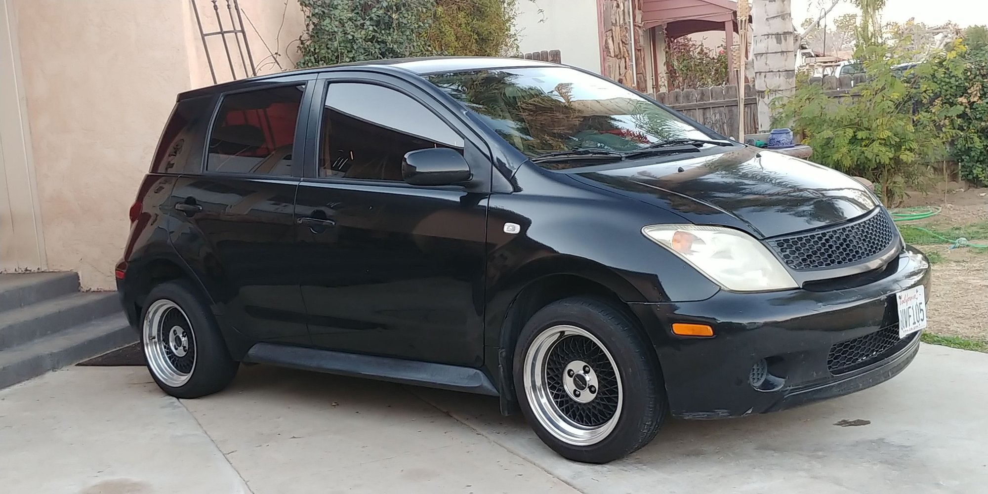

Need help with 2005 Scion xA.
My Rear Signals are not blinking or getting power. All fuses are good. Dash indicator works fine and front signals work in turning or hazard mode. Just the back turns are dead.
The flasher is flashing faster as if a bulb is out but all bulbs check out good. I cleaned the contacts for the socket in the rear lens and still nothing. All I can think of is a bad flasher relay?
I just got this car about a week ago and the signals were working fine.
Any suggestions would be appreciated before I pull my hair out.
