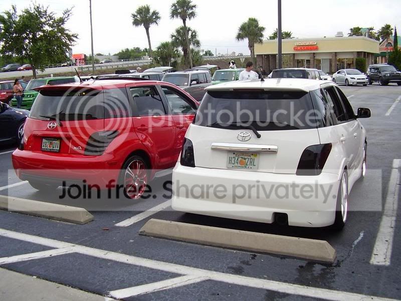

well some people wanted to know how to do it so i just wrote this up. its a very rough "write up" but you get the idea.

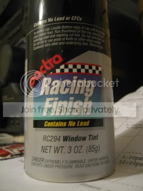

i went to a a local hobby shop and bought window tint:
remove the taillights (simple 2 10mm nuts)
lightly sanded it with 2500grit
clean the lights
spray the desired amount of coats on.
then spray the desired amount of clear on it.
if everything goes right it shouldn't take more then an hour.
i let it dry over night then install.
end results are as followed
simple ^_^

pretty dark, but looks good.

can i get a picture of it with the brake applied please
