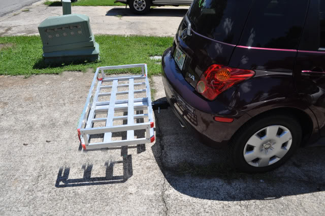

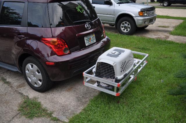

I bought:
1 trailer hitch from Uhaul $160- cheapest place I found (they gave me additional 10% making it $144)
1 $13 1 1/4" to 2" hitch adapter from Harbor Freight (Used a 20% off coupon)
1 $50 aluminum cargo carrier from Harbor Freight (Bought it on sale + 20% off coupon)
So for around $200 I added a lot more cargo area. I think this will really come in handy on road trips.
Attached Thumbnails Need more storage for your xA?  Here is a good solution...-scion-luggage-rack-002.jpg   Need more storage for your xA?  Here is a good solution...-scion-luggage-rack-003.jpg   Need more storage for your xA?  Here is a good solution...-scion-luggage-rack-004.jpg

I edited this photo to show you what it will look like when I shorten the square tubing.
