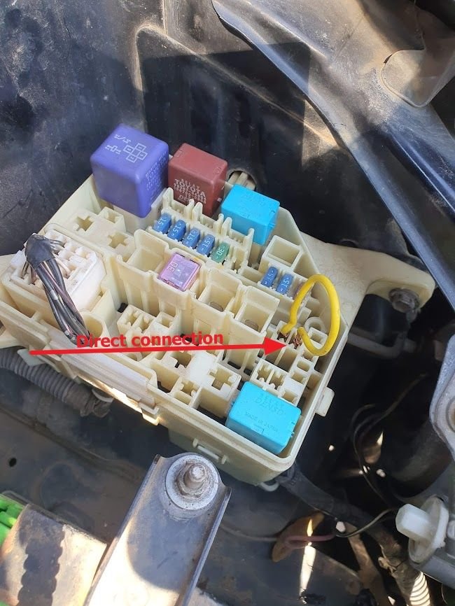

Guys, Thanx for your responses. I finally figured out what was the problem. my problem got far worse to the point when the car shuts down even if i waited for 5 - 10 mins as before the car wouldn't switch on....so I did a Fuel Pump swap this didn't solve the issue. Then we found out the Ignition relay was already weak so we replaced that and the car worked for a couple of days without an issue. but then the problem happened again. Now usually there is a wire harness with a connector from the car switch/key area going to connect another connector which then takes the wires to first fuse box near/under the steering wheel of which some of those wires will run towards the external fuse box near the battery compartment..which completes the full ignition system... In my case we found out that the previous owner may have had an alarm/security system installed of which logically would stand in between the key/switch cable and the fuse box so it can monitor and do advanced controls like shutting down the car etc etc... now this device has now been removed out/disabled for some reason so the key /switch harness was connected to the connector of the alarm system even though its not there or disabled ... my electrical mechanic just then unplugged the key/switch connectors from the alarm connector and back to the original connector which goes back to the internal fuse box etc etc..meaning by passing the alarm/security system all together. This resolved the car issues now I have been driving over two weeks with no issues
Another tip is if you are stuck somewhere and u think the relay is dead u can swap the horn relay with the ignition relay as they are same..in specifications.. but if the car still doesn't startup there is a little trick we attempted which made the car switch on by jumping/by passing the relay but this
is not advisable. U should unplug the ignition relay from the external fuse box under the hood and connect a wire as shown in the picture this will connect the ignition system directly ....only use this to get u out of a bad location and to a mechanic but not as a daily driver see picture.
Hope this helps others out there with Toyota IST / Scion xA cars and maybe similar models too.
