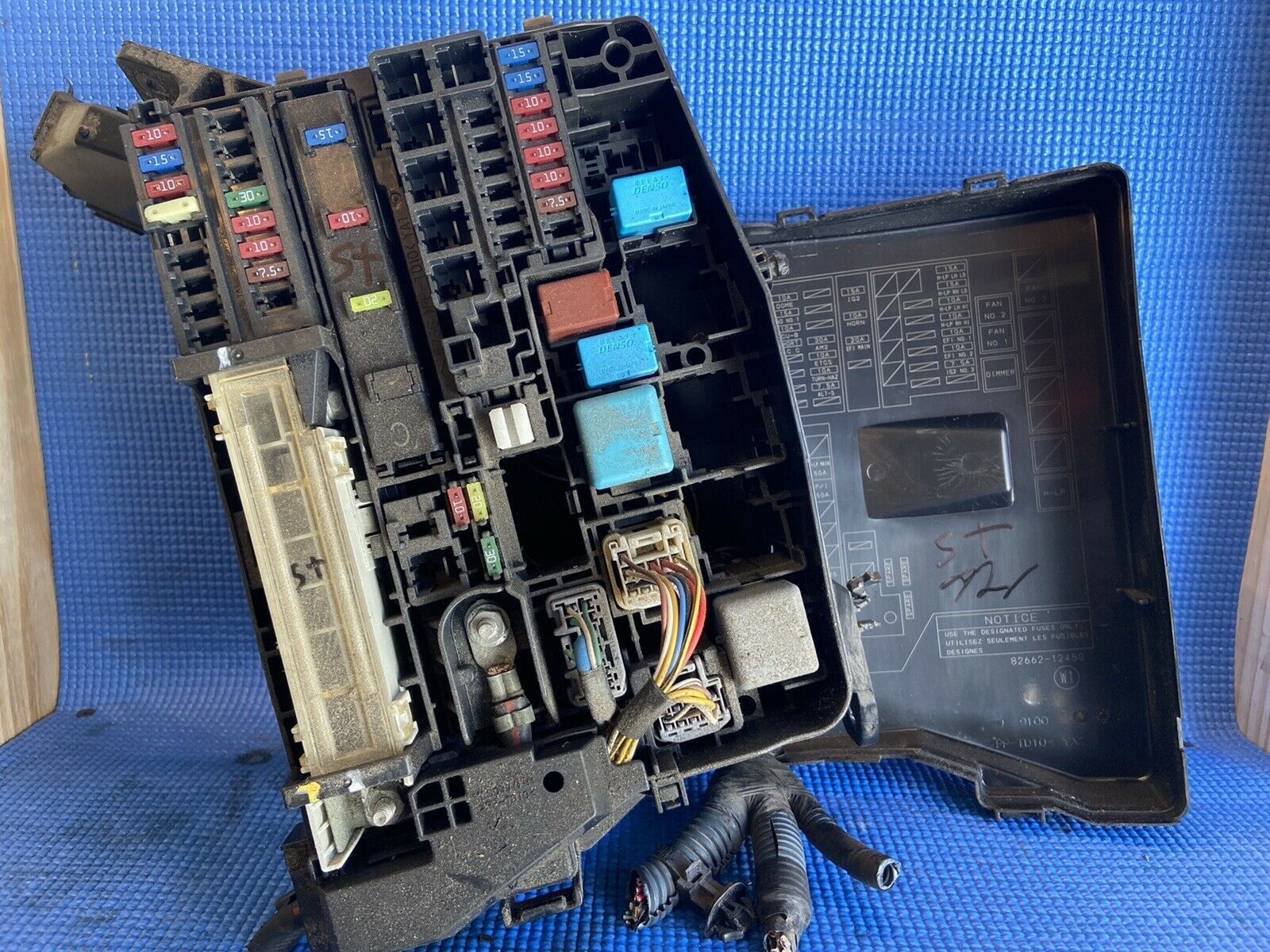

When you disconnected the battery terminals you may grounded out the positive and blown one of the fusible links. They are in the engine compartment fuse box under the white cover on the right side when looking at it from the front of the car. Test them with a mulitmeter to see if one is blown. If it is you have to replace the whole block together, they are not individually replaceable. Even replacing the block is a pain but can be done. Service manual says to replace the whole fuse block, but that is costly. Here's a pic of the fuse block, the white portion is the fusible links.

Sounds to me something went wrong when the battery was re-connected. Once I connected a Honda battery backwards and it blew a main power fuse and nothing could get power anymore just like your situation no radio, fuel, etc. Maybe something shorted when working with the cables. Check "EFI MAIN" on engine fuse box I think 30amp fuse.

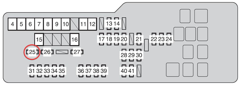

Old Feb 8, 2021 | 07:08 PM
Chunjee's Avatar
Joined: Nov 2019
Posts: 114
From: Portland, Oregon
