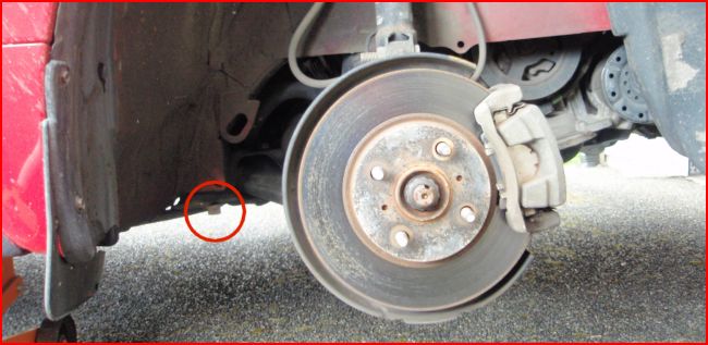

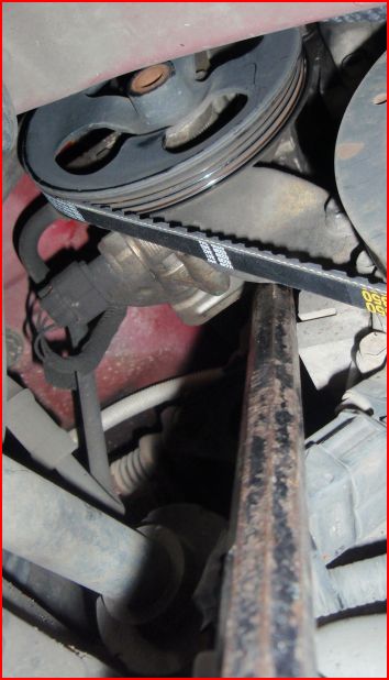

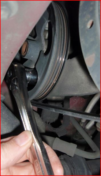

The only way I know of is to jack the car up, pull the passenger side liner that's under the engine, and then loosen a bolt that's behind the power steering pulley. The pulley has holes cut in it, so if you rotate the pulley you can accrsss the bolt. What I end up doing is putting a crowbar between the power steering pump housing and the engine from underneath, then prying to get tension on the belt. With tension still applied, I tighten the bolt that's behind the pulley and that seems to do the job.
You'll need a crowbar, jack, jack stand, and a 14mm socket and ratchet. I also remove the passenger wheel just for easier access, but it's not required.

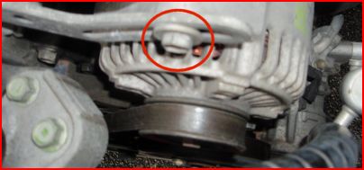

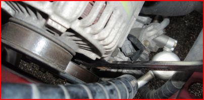

I just did this so I took some pics for people looking at doing this in the future.
