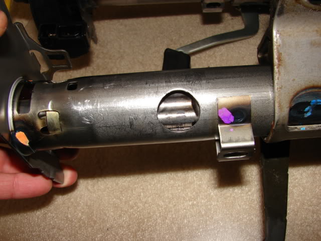

You need to replace the BB ignition lock assembly with the XB one, because it has a different shifter lock cable (no picture yet). There is also a difference in the position of the lock assembly on the steering shaft. So, you also have to replace the steering shaft with the XB one.

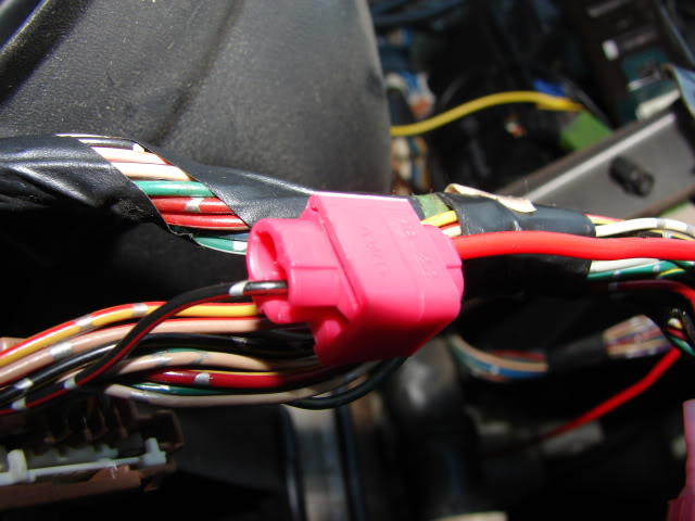

Then there is 3 wires for the shift lock switch. One is a ignition wire (red/black). I just traced an ignition power source and spliced it from there. This is a cable from the instrument panel.

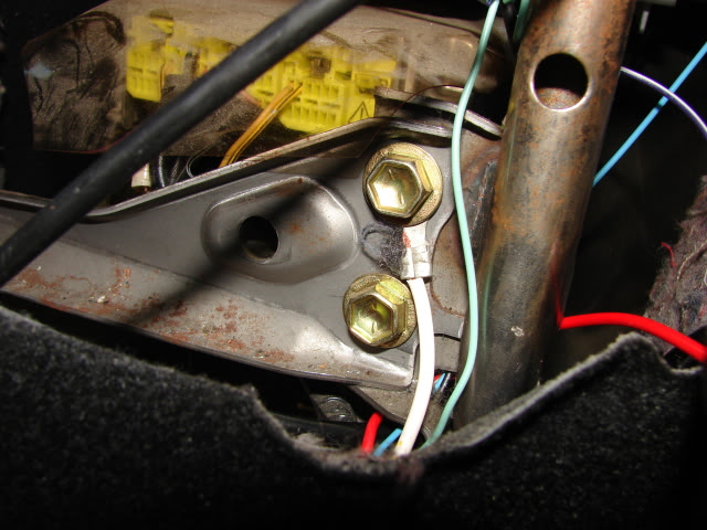

Second wire is a ground (white/black). Just any good ground connection will do. Name:  DSC04951.jpg
