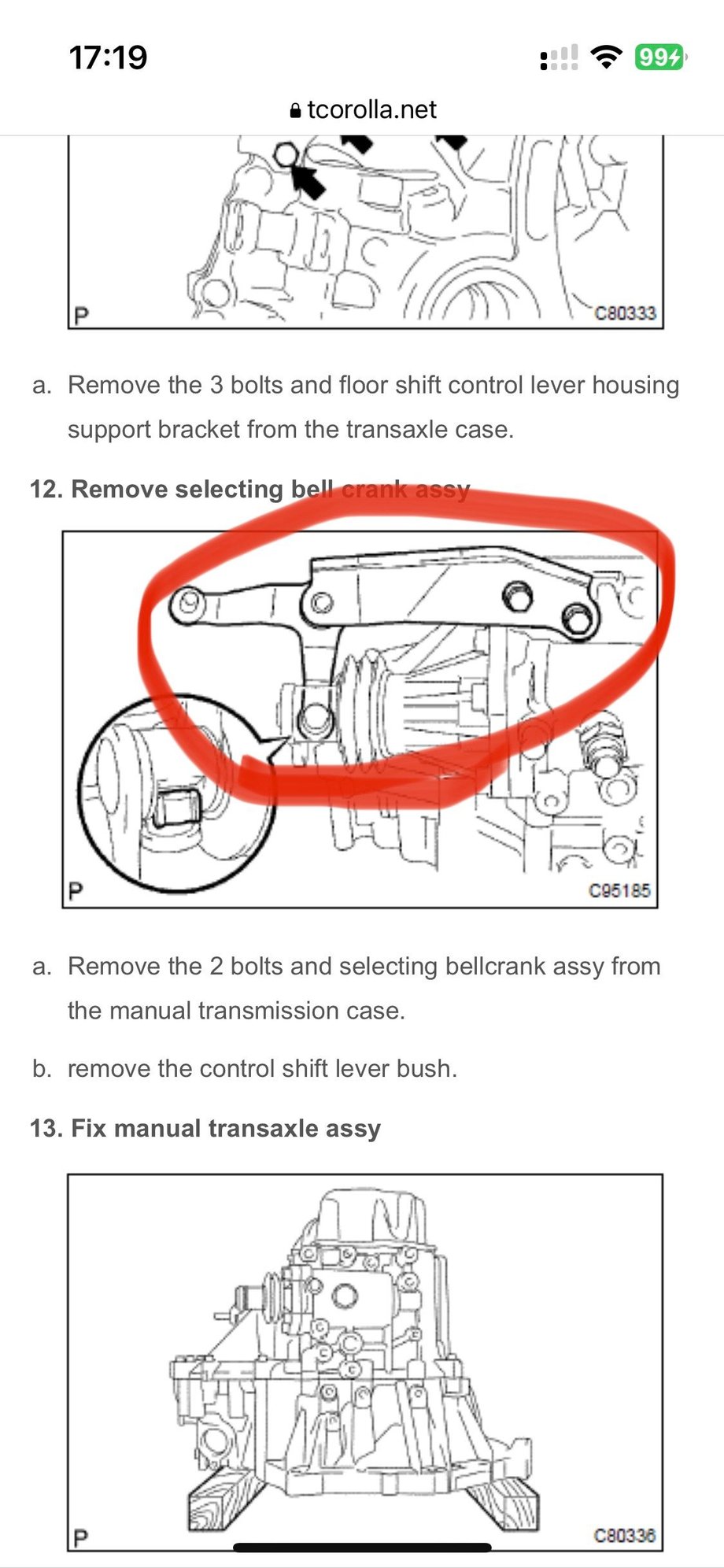

I recently picked up an 05 Scion Xb with a grenaded transmission. I got a C150 transmission for it and everything bolted up great and the car drives great. The only issue I ran into was that the forward /neutral/ reverse selector on the C150 transmission was longer than the original C50. I fanagled the bellcrank arm assembly to work by moving it forward but it's only held on by one bolt and I had to add washers underneath it so it would make good contact with the gear selector but I would like to find one thats longer and made for the C150 so its a better fit. Does anyone know where to source this part?
