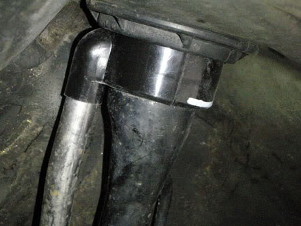

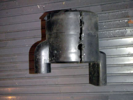

Found this thread very helpful and wanted to contribute a few bits of info. My xA suffered this problem at ~115k miles at 5 years old (2006 model). First, buy the parts online. The local dealer quoted me ~$500 for all the parts. I found them online (an OEM parts dealer online, who turned out to be another local dealer that would only honor these lower prices if you ordered online, even if you went to pick them up in person...???) for ~$320. Second, the part swap is practically as easy as an oil change. The pump assembly and filter are really easy to access and come off the car by unplugging a few things and undoing 3 bolts. The filler neck parts are easy to replace too, but took me a bit longer since the assembly wasn't shown in any manual. I had to figure out how it was put together; they're simply press fit into the rubber surrounding the parts. Third, the factory service manual has a multi step process to check the function of the pump assembly (the most expensive of the parts at around ~$250) to figure exactly what was wrong with the part, but I didn't bother. I didn't see/hear any water in any of the parts though. Lastly, here are pics of the parts:
Top is the filter and bottom is the pump assembly.
Old filler neck parts, notice the protrusion on the right side. There seem to be drain holes up inside that protrusion.
New filler neck parts installed, notice no protrusion on the right side, but there are still holes there. I don't know how this design can be less prone to having water go down that vent pipe on the left.
If anything, I would think that protrusion on the old part would help keep water from splashing in to this filler neck part...??? If I get this CEL again, I'll examine these parts a little closer, but I was just happy to be done.
