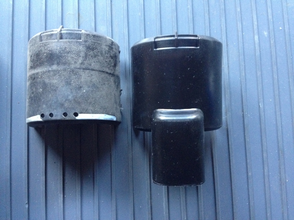

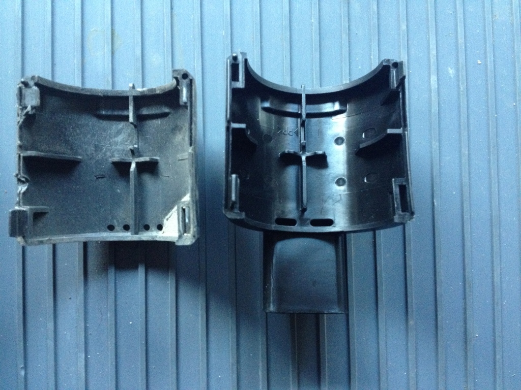

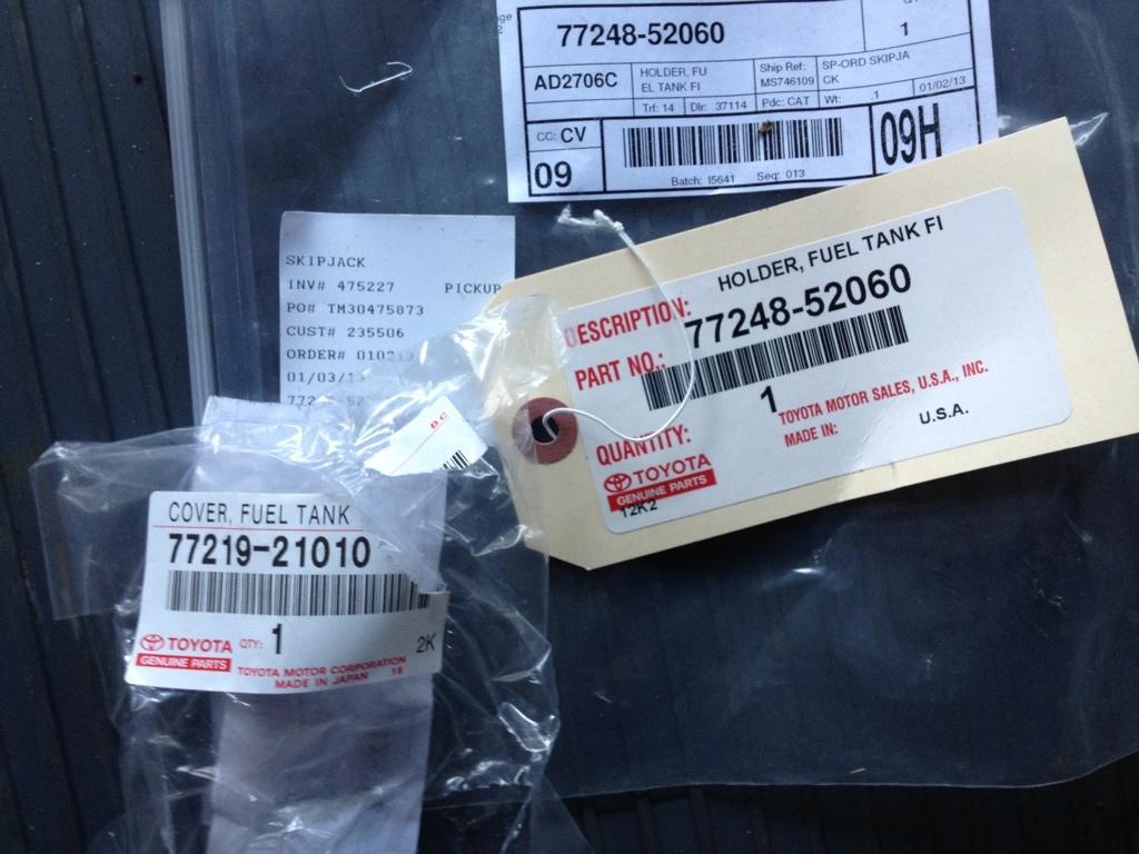

So the same error codes popped up on me again after fixing the problem ~2 years and ~35,000 miles ago (see my previous post on 3/18/2011). My 06 XA now has approximately 150k miles and the codes came on around Xmas of 2012.
As I went to buy the parts online for the 2nd time, I noticed the fuel filler neck part numbers in the TSB came up as not available for Scion. In the online parts search, you get to pick between searching for Scion or Toyota. Since no Scion parts showed up, I tried searching under Toyota and got a list of Yaris parts. I looked through the Yaris parts diagram and ended up buying them, knowing the 2 cars are practically the same.
Here are the 2 filler neck parts I ended up buying:
I noticed that the new parts resembled the parts that were orginally on my Scion before I did the TSB fix the first time...
New is bottom, old (from first TSB fix) is top:
Below is a better look at the part that is different. Like I said in my first post in 2011, I don't know why the parts I got for the first TSB fix got rid of that extra protrusion since you would think it would help with stopping water from getting in, more tortuous path with that inverted snorkel looking protrusion.
New is right, old (from first TSB fix) is left:
All the other parts from the TSB are still available, no difference from 2 years ago.

The install had no surprises, codes went away after the installation of the new parts.
I can conclude that water is the cause of this failure, not gasoline or any other liquid getting into the canister. I don't know the exact functional process of this part of the emissions system, but I think water is getting in, soaking the media, and creating a blockage.
I don't know exactly how the water is getting into the canister. If the aluminum pipe by the filler neck is the air input port for the canister, I can see water coming through the gas filler neck door and then seeping through/around the filler neck components to get into the canister. During my install, I used a gasket sealant to assembled the 2 halves of the filler neck plastic pieces and then used more to seal that assemble to the actually gasoline filler neck. My goal was to get the air entry to only come through that snorkel looking thing on the new filler neck part.
I kept my old canister and pump. If the codes come up again, I'll try re-installing the old parts since to see if they work since the canister should have dried out by then.
