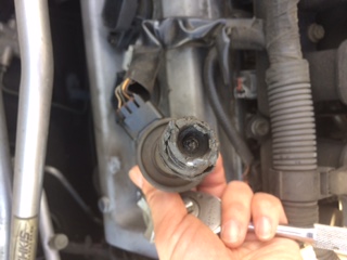

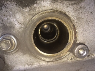

i'm afraid to ask but my 05 xA made a loud noise while i was driving on the freeway, which made idle like it was going to stall. there was an obvious lost of power and idle was unstable like it was goin to stall. i was still able to drive but at the same was scared. i eventually made it home to discover that my valve cover was cracked. as i removed the cover, i noticed right away that the cyclinder boot blown off and out the spark plug well. my car was making this ticking noise before it blew, i wasnt sure what it was since it was the first time i heard it. as far as i can see, the well seems dry and i don't see oil or coolant. the tip of the spark plus is mangled from the explosion. i use NGK iridium plugs, and noticed the tip and medal flange is now touching but i'm assuming that was caused when it blew. i am lost for words and uncertain what to do next. please help, any advice will be useful. thx in advance.
