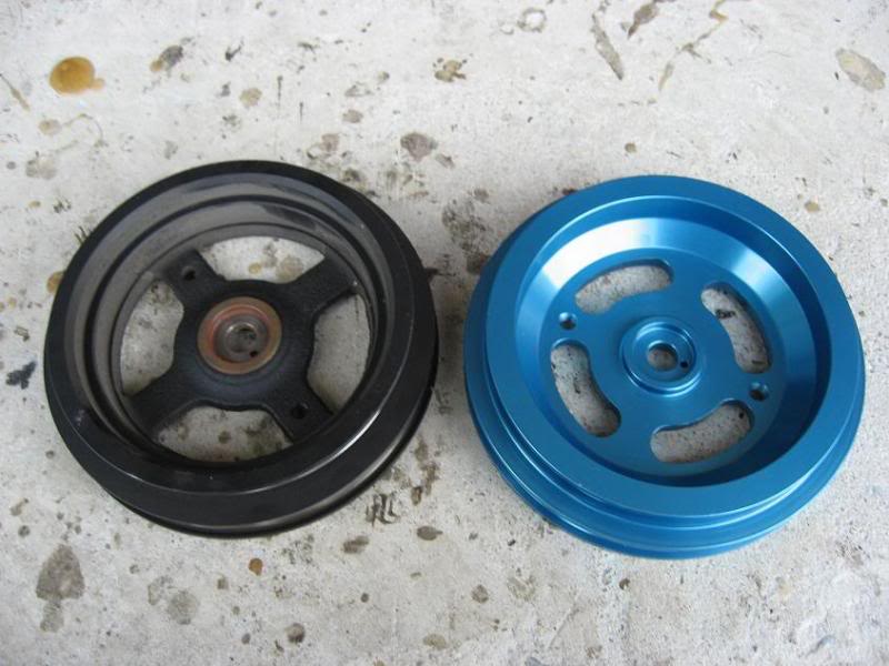

NST, i received my crank pulley today and it had a nick on the outer portion. will this affect the performance of the pulley? if it is no big deal i'll just keep it.
That nick/notch is for timing alignment. I have the same too.

They are in (CR and Alt pulley). Definitely a beast to work with that damn cable... but the throttle response is much improved. I'll get pics posted shortly.
Edit... picture time!
From out of the box:
To, it's still on the box:
Alternator time:
Last up... it's on the box.
The difference is definitely noticeable on the throttle, even with a fail-o-ma... er automatic tranny.

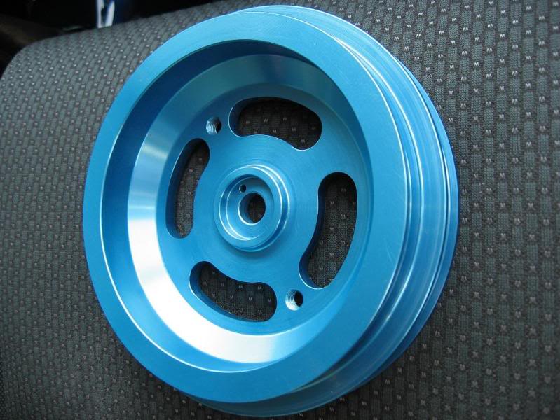

Nice pics, Spr0k3t.
My pulley showed up today!!!
This is a beautiful piece, NST! Thanks so much for reaching out to us xB'ers with a great product and a great opportunity! I can't wait to install it tonight!
Here's a pic of mine.
