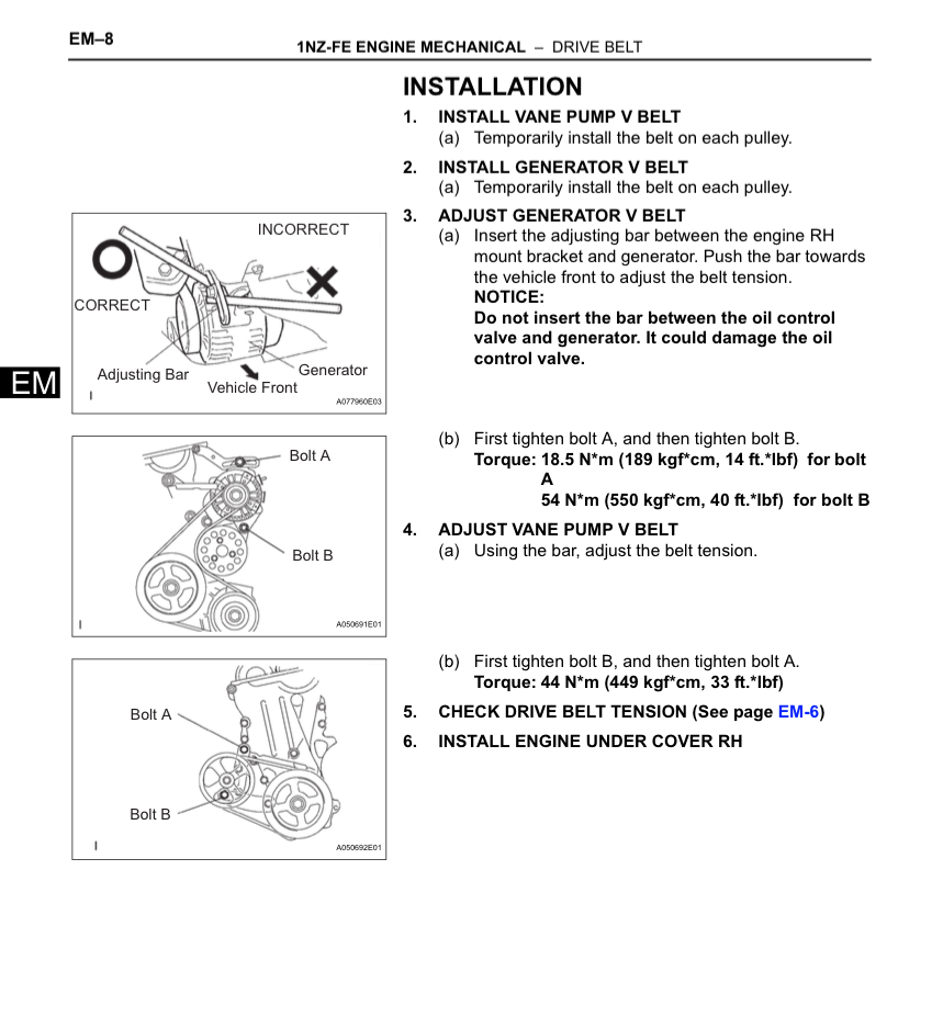

You may as well change them together since you'll be in there anyway, here is a pic to give you an idea:

Tightening the alternator belt is easy. It is the second belt down below, for power steering pump, that is more difficult to get to.
