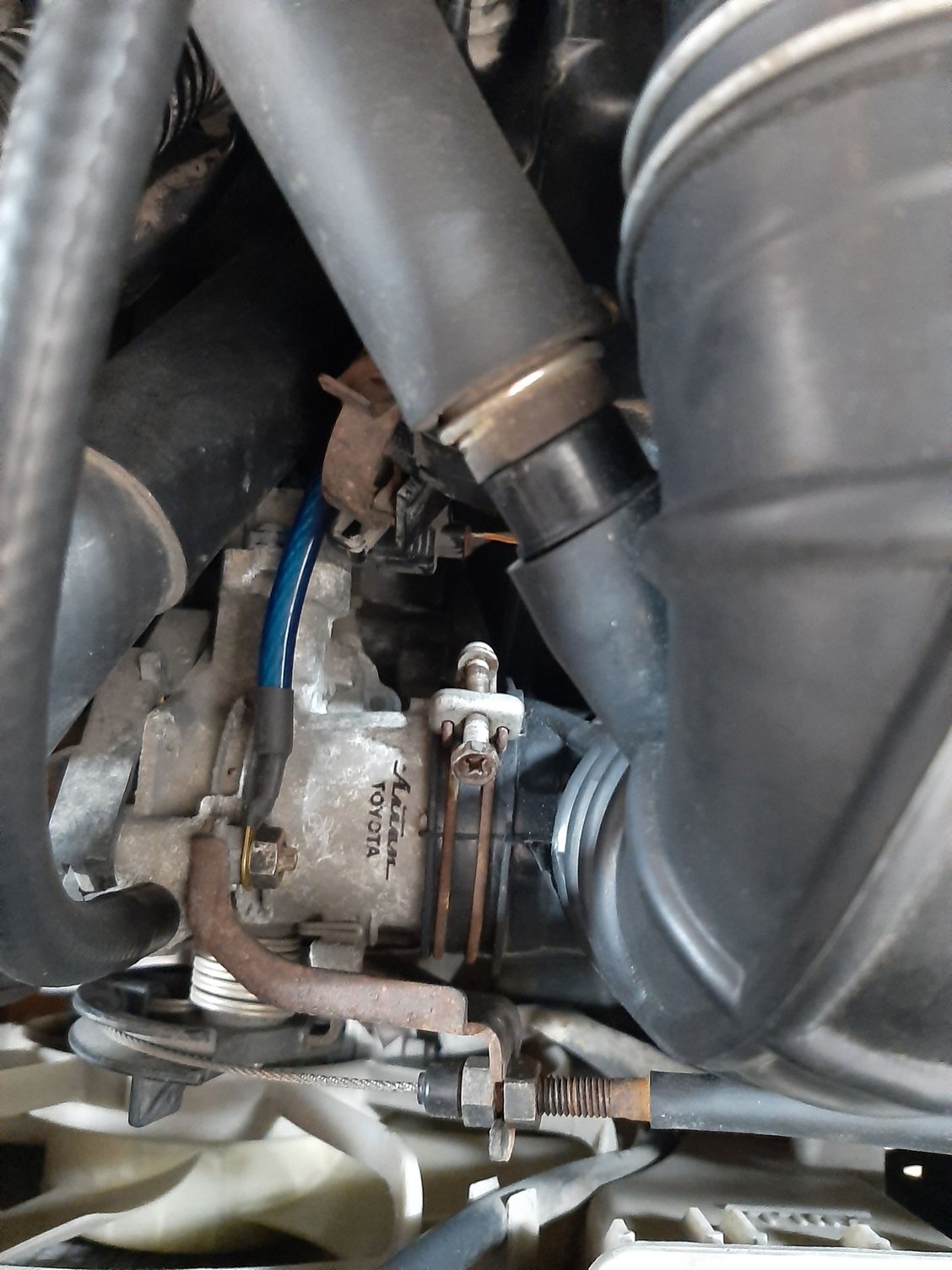

How about tightening up the throttle cable adjuster by the throttle body......cables stretch. Mine had slack and all it was was adjusting the slack with the adjuster. Follow cable towards tb and right where the bare cable comes out there is a threaded part bolted to a bracket.
Loosen the nuts and move the cable cover threaded part away from the tb and magically the slack goes away. 2- 10mm wrenches is all it takes and it is right up top in front to left of battery when looking under hood. Do it, you'll get your 20% back.

Suggest it to the instructor, point out the floppy pedal. Then open hood and point to the part like in the pic and tell him it needs to be adjusted and impress them with your mechanical prowess...............bonus points!

I was thinking if the gas pedal was floppy too. I'd imagine if the cable was messed with intentionally maybe they would correct it with extra spring but i dunno. I was looking at your picture and just thinking if it was that loose could the cable come off the pulley? The adjustment must be all the way out.
thinking about it you'd probably need the weight of the pedal flopping down to keep the cable taught so it wont come off

Hoping my cable doesn't stretch any more because I'm about maxxed out on adjustment. would have to use washers on bracket to move it further back to get any more slack out........or buy new throttle cable.
