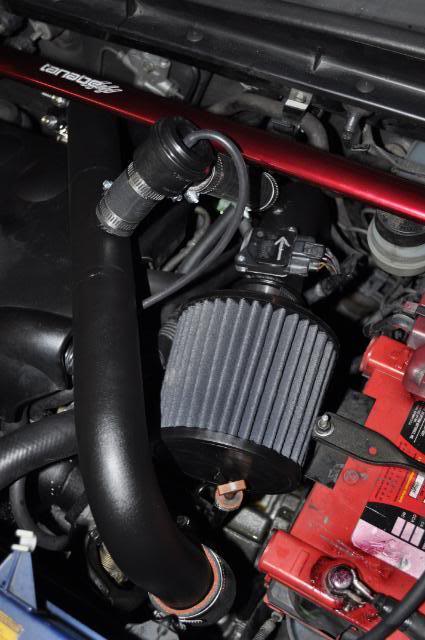

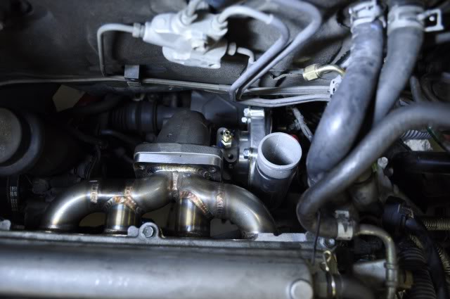

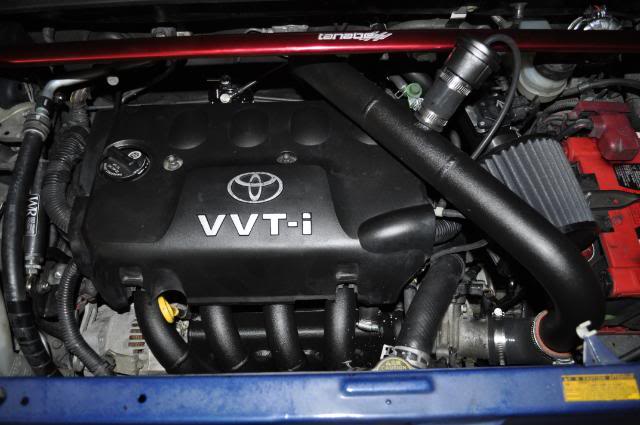

It took a minute to get back here on this Scionlife thread with info but we have it ready and here's your Descendant xB1 "Tuner Friendly" turbo kit.
Installed Pics:

*pre wastegate. Manifold in kit includes TiAL Sport MVS Gat

not a bad price at all for those parts.
However like I said in the begining, it would not be a 100% ready to go plug and play kit for 2k.
So add the AEM/FIC with harness and a set of R/C or precision injectors and your at 3,000.00 with incindentals still needed.
Also intercooler? thats another 350.00 to 800.00 depending on brand. so now were at close to 4k
Rob, from the exhaust manifold all the way out looks great. But that cheap hose and worm gears and black pipe look like you went, oh **** need to cut down on the cost. It almost looks like two turbo kits put togeather. A killer back half but a less than pleasing front half. I.M.O
I think this kit will have it's challanges meeting customer needs and ease of use.

I have to agree with Xbgod exhaust manifold looks great, but the cheap hoses with the black pipe make it look tacky.
But Rob I have to congratulate you on the cleanest exhaust manifold setup with TIAL. I have ever seen so far in all the years I have seen turbos on xb's.

You may want to mention, judging by the downpipe length that the stock exhaust will need to get cut pre-cat. I just went through this on my own setup, it can be a bit of a PITA. What flange are you using, 3-bolt flat gasket? Big thanks for including the flex pipe, makes alignment MUCH easier, wish I had done that on mine vs. spot weld, fit, cut, reweld, fit, etc.
