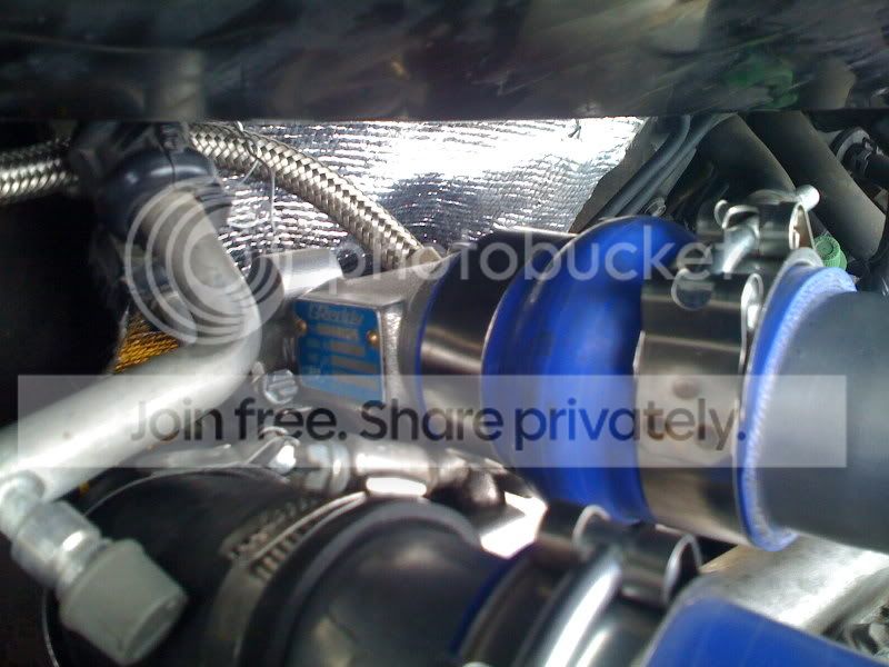

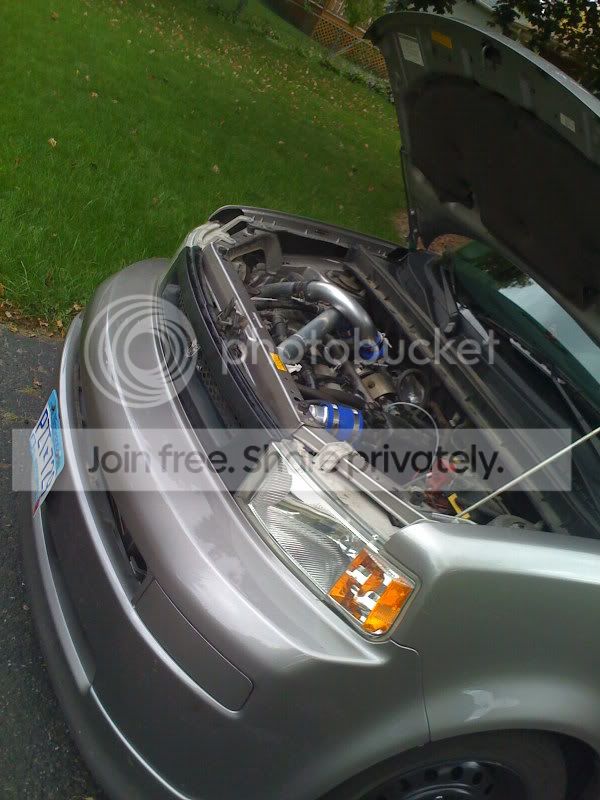

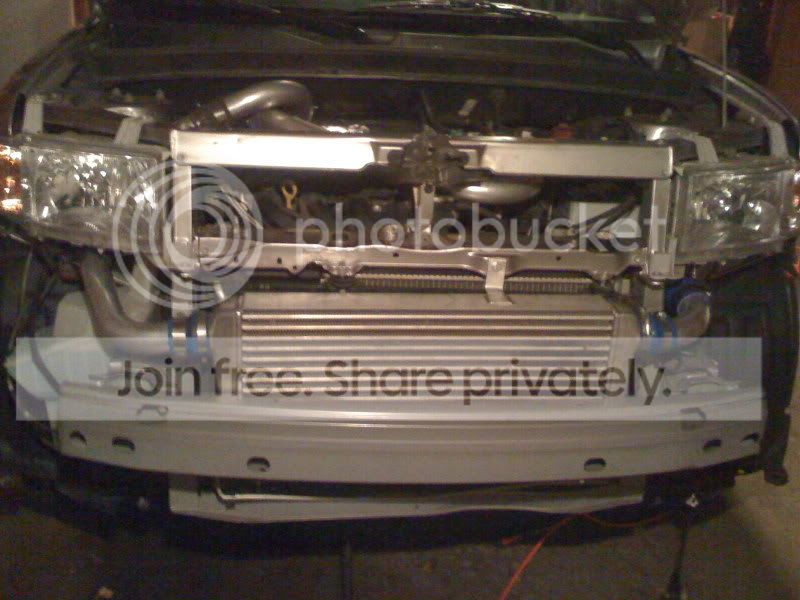

I finally got a Turbo on my xB! Its a Greddy Turbo kit with Greddy intercooler, Emanage Blue. I also have bigger injectors for it, but I'm debating whether to put them in or not..

not bad... but like i've mentioned before, i don't like this kit due to it's piping being all over the place. i just feel the charging can be done much more efficiently...
get rid of the air box, turn the turbo the other direction, clock it and use an external waste gate. have intake be only about 18 inches in length, have hot side go over to the left and down the side of the engine to the IC, cold side back up to the intake plenum. half the piping used and a more effective and efficient setup IMO.

Yah, this is my first turbo I've put on one of my cars so I'm not trying to get all crazy with it LOL. It's a daily driver and I'm not really trying to go fast haha, it is a xb after all. I got the greddy kit because I got a killer deal so yeah, the piping does look like it's all over the place. Maybe if I get a new car I might mess around With the piping

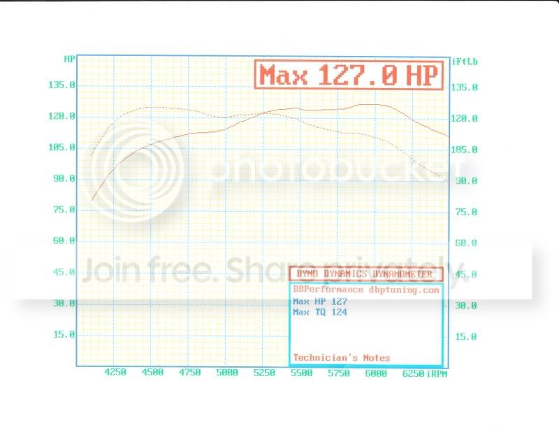

finally got dynod lol here is the sheet

Looks like a good dyno until you look at the RPM range.
good results for just 4psi, no injectors, no pro-tune, etc.
i wish someone would keep it at 4-5 psi, run a smaller turbo, and run a good tune.
Lets see the results with a tune buddy!
