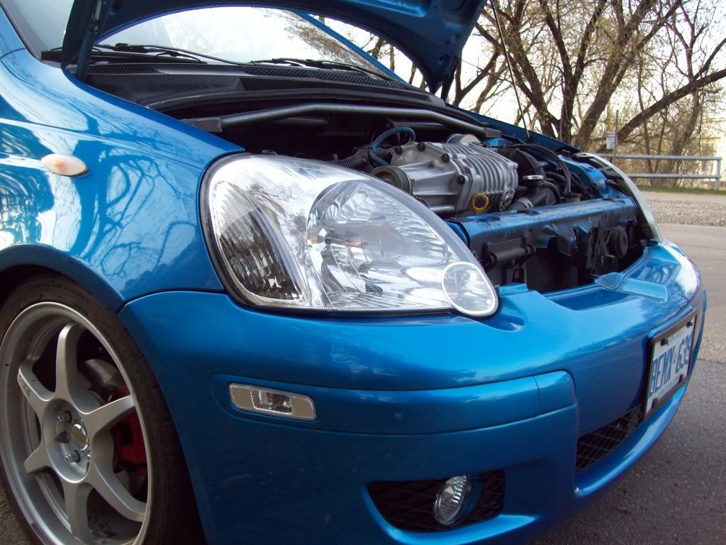

Well, If it isn't installed in the car you can just pull the plug from the supercharger housing and tilt it on end to drain it all out. If it's installed, i think you can unbolt the front portion (I think it's 8 bolts, you can see four in this pic) and the oil will drain out. You will then have to reseal/reinstall it and add the oil through the fill hole. I'm not 100% but I think that will work. To make sure you could contact Magnuson. I wish I changed it before I installed, but no biggie.
