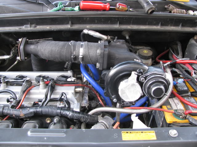

i used the stock manifold, cut it, and flipped it over.
*****So after another month of waiting, and a few days of hardship with oil issues, my tubro is done, and im posting up the build.
*stainless mani and DP heliarch welded
*volvo td05-12b turbo
*35mm wastegate (open dump)
*tc injectors
*CXracing intercooler
*bosch copper plugs

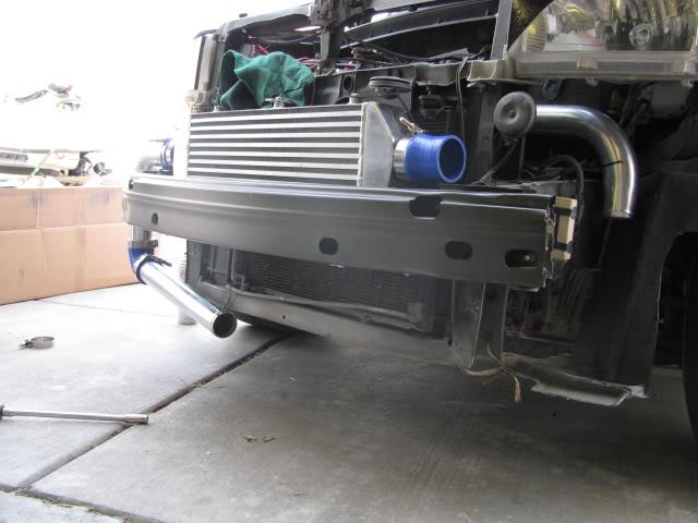

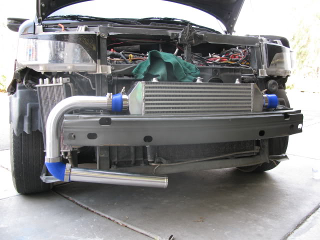

Size:  51.3 KB ftting the IC
Size:  58.6 KB routing the pipes
Size:  57.4 KB lower pipes

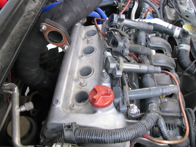

Size:  70.4 KB changing out the plugs and the injectors

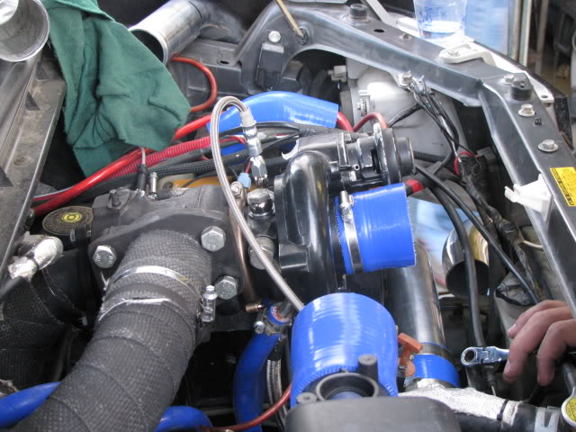

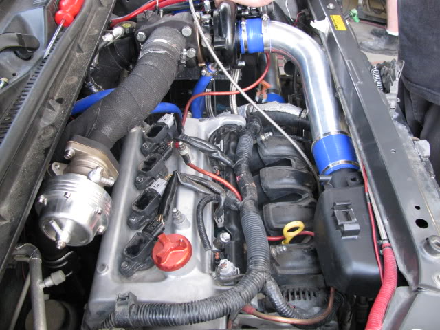

Size:  81.7 KB turbo bolted up
Size:  76.4 KB getting things hooked up.

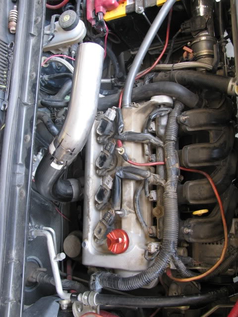

Size:  81.3 KB used the stock airbox as a temporary intake till i build my aluminum air box.
filter in cap allows oil return to drain into breather on valve cover
i will get a diff banjo fitting so the oil line doesnt stick up like that.
Size:  81.5 KB turbo and DP are kinda close to brake, so i ghetto fabbed a heat shield till i make a carbon one.
sexy blacked out pipes, and grill trimmd to fit. fairly stealth

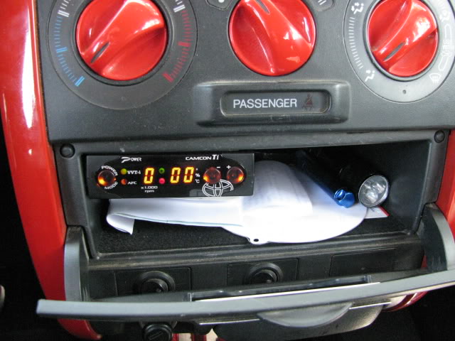

Size:  61.6 KB my camcon hidden away.

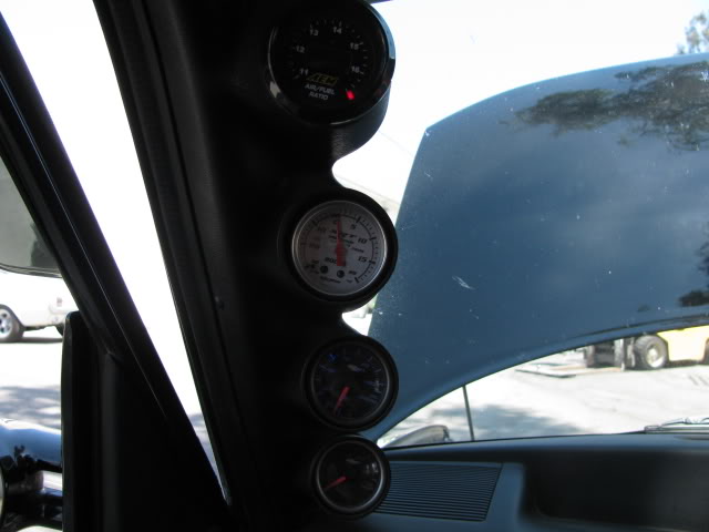

Size:  36.5 KB AFR, Boost, Oil prs. Oil temp (oil press sensor died)

Size:  32.0 KB boost guage from my friends srt4 haha, hey it works
Size:  43.5 KB and just showing off my guage
so, im running 5.5-6psi open wastegate. she's pretty stealth until the wastegate opens, then people look over at me wtf was that?! lol its awesome. becuase the pipping and the turbo, and the stock air filter, from a dig she doesnt spool till 3700 or so, but any other gear will spool pretty quick. im running afr's of 10.6-11 or so, but my only tuning device is a camcon at the moment, so it fluctuates a lil. 6psi feels amazing tho, she pulls very hard. my friend will be going to a dyno with his srt ina month or so, and i plan to go with him that day so i can have my car dyno'd. but it feels like it pulls harder than my 35 shot did and i ran a 16.1 1/4 with that shot lol.
