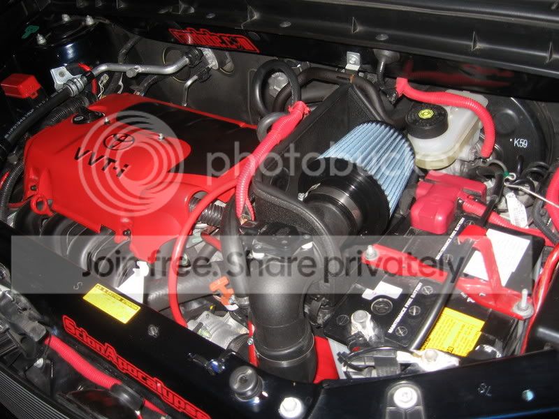

did require a tiny bit of customizing to get a more solid fit, but i love my aFe

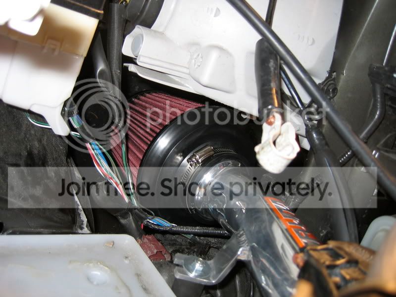

That ebay intake looks like garbage. A real one isn't that much more...
Here's a Fujita SRI on my car.

I have aFe also, look at my profile for a pic of what it looks like in an xA if the xB above doesn't work for you.

did yours fit snug on top of the airbox? mine always came loose until in clamped it in place

Mine didn't fit perfectly. I thought it would, and it looked like it would in all the pictures, but nope. A friend helped me put mine on, we had to unscrew the metal piece holding a hose or two right above the back of it so I could bend the metal heat shield up to fit into the rear clips. Then the rubber elbow was slightly too long so it took some force to get it connected to the piece that the filter is attached to and the third thing was the left side of the heat shield isn't angled perfectly to match up to the stock front clips and it took some force to get it to latch. Oh, and since I have an 06, I was supposed to reattach the little vacume box (not sure exactly what it is) upside down from the way it was on the stock box but I didn't like the way the hoses were positioned so I put it back on the right way and used some washers since the spacer that came with it wasn't thick enough.
