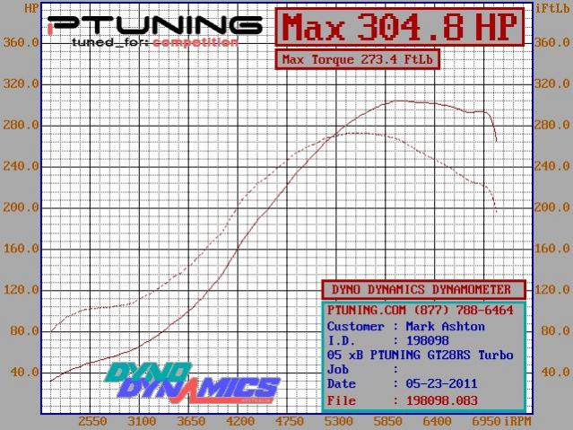

Dyno Graph For the xB
Attached Thumbnails PTUNING: Scion xB1 Build (Pics & dyno on Pg 2)-ptuning_305whp_xb1.jpg
Wow! Gotta be a blast on that xB1.
You might want to edit out the customer's name on the dyno sheet. He may not want his info out there like that.
