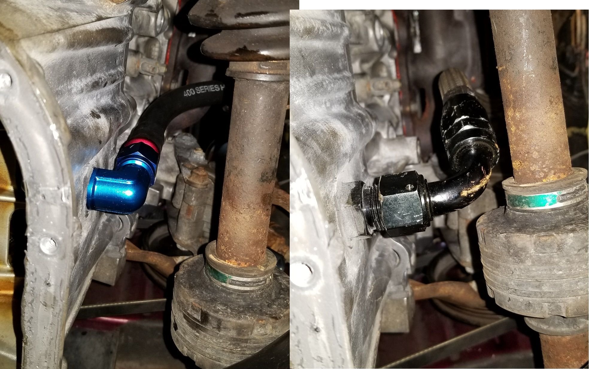

So this was a pretty upsetting holdup. I had the black fittings and as you can see they don't fit at all with the axle. Looking at the rest of the pan there is pretty much no other place you could put a bung. Well at least I cant. I thought I was going to have to use the pan with the fitting.
I'm sure going in the cover is probably the worst spot to have the oil return BUT I found out they make 90deg bulkhead fittings so I got one of them and some push lock hose. Luckily its low enough profile that it fits with generous space. Also FORGET braided hoses the push lock stuff is way better!
So now basically I have to put the bumper cover on, assemble the hubs, fill the fluids, hood and then check everything again.
