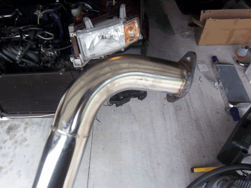

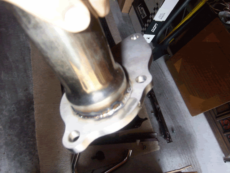

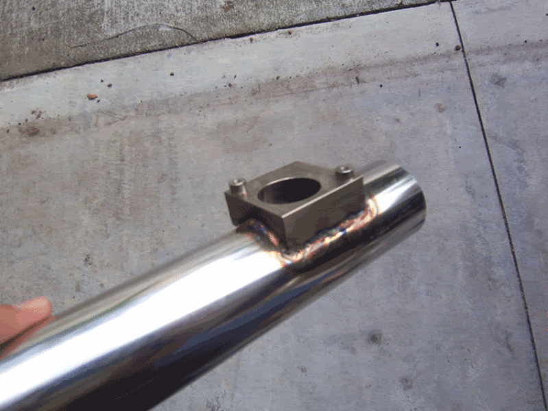

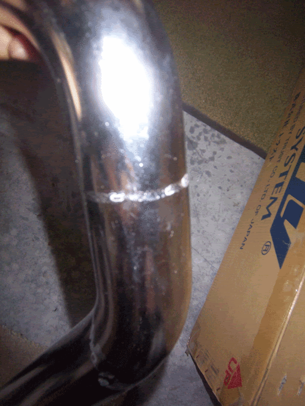

Your right, some of those weld accually look like dimes like they are supposed to. And that air filter looks like its about the same height as my AEM CAI was. Even with the speed humps in my development, I have yet to scrape. The worse work, was done by the local muffler shop relocating the Cat.
Originally Posted by rollhard
I hope it was a prototype. Would you install something that looked like this on your car?? Look at the welds, etc.
Awesome mild steel welding!
Wow, awesome ground clearance!
Water in the filter? No worries, its a good 4-6" off the ground!
AHH loooks like one of my welds using an arc welder
The welding the muffler shop did looks worse than it is. I think it was done with a mig using flux core wire. The rest of the pieces look pretty good, still not a good DYI.
